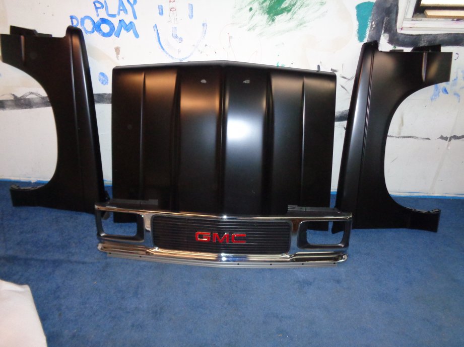

I have been really surprised with the prices for s10 parts actually a lot cheaper than a full size 150 for both fenders shipped grill was 70 bucks hood was a little over 400.
pretty much the only expensive stuff left is exhaust and maybe a chip for the computer.

new fenders hood and grill

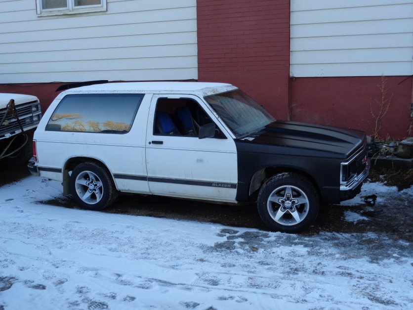

got it running enough to get it out of the garage and its going to the exhaust shop tomorrow.

F**K YEAH! I f****n' love those wheels

ya its hard to believe they are a stock gm wheel
zq8 wheels for the s10's
they look awesome on a 80's monte carlo or malibu

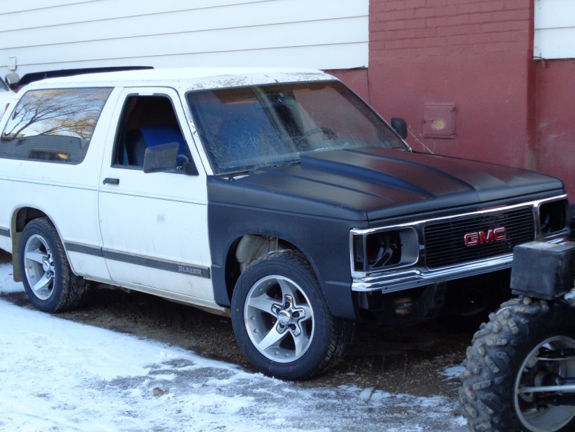

finally got it back from the exhaust shop yesterday 2.5 pipe with flowmaster 40 series. no mistaking that it has a v8 now it has a good rumble to it.
got some plastidip and painted the front clip to temp. protect it from the weather until I can finish the body work and paint it.
all that is left is to modify the new core support for the radiator and install the front clip.
I drove it around the block after getting it home definitely needs a posi in the rear. it is a quick little bastard now.

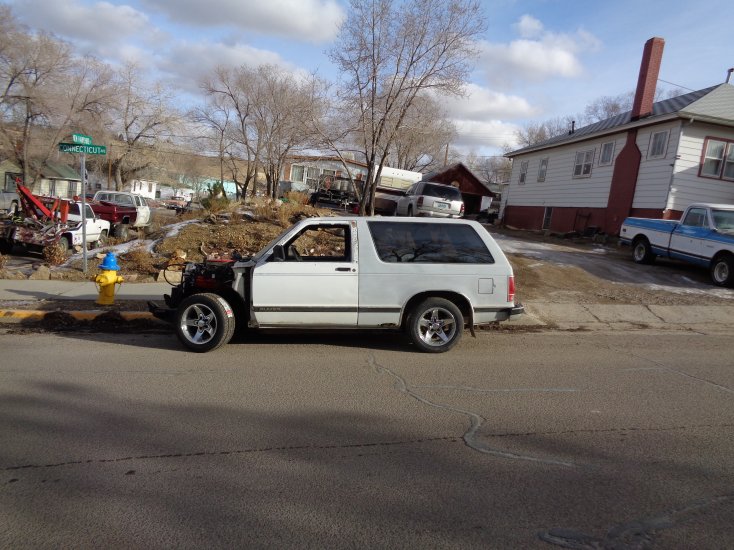

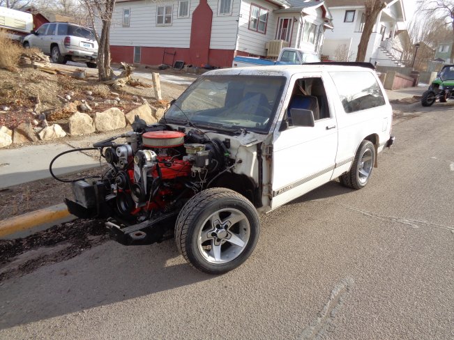

front clip set in place I need to get the inner fenders in and adjust it all
