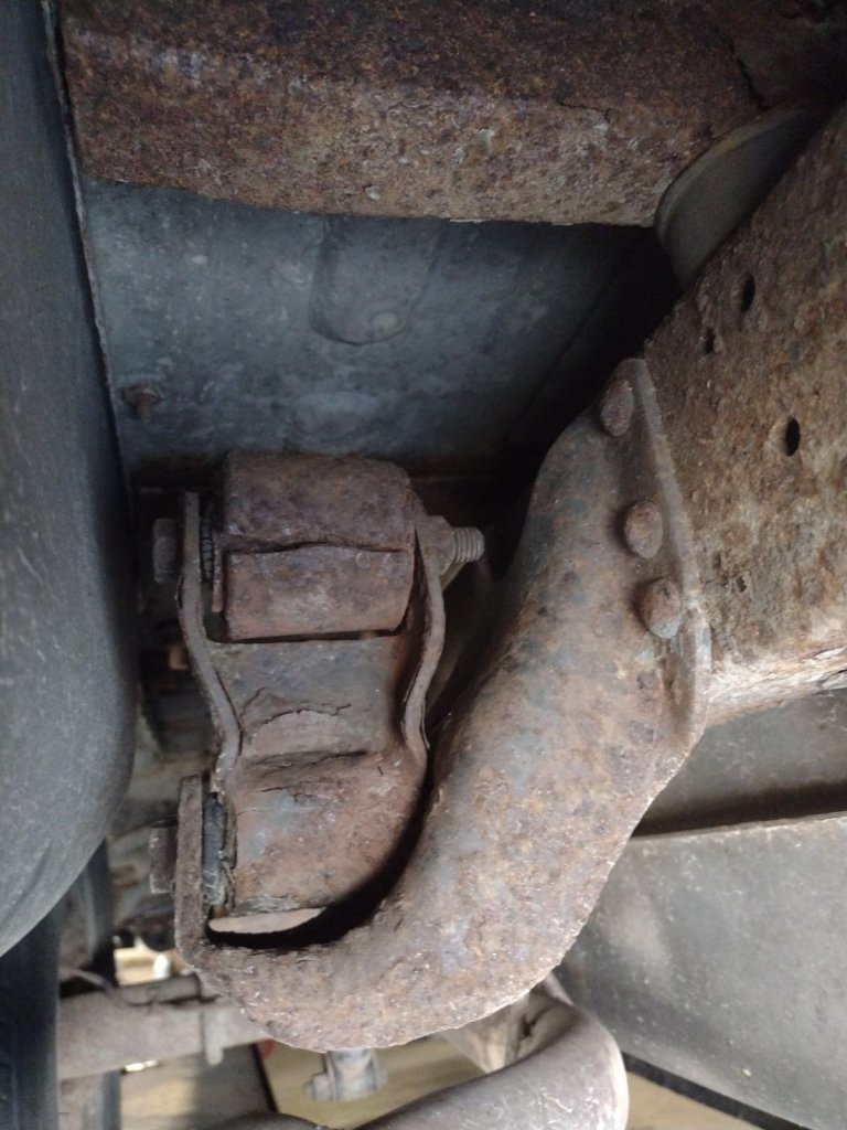

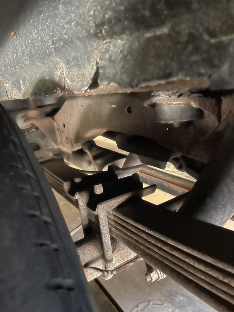

Boys I need some help. So I went to do my lowering kit and it’s been nothing but a mess but anyway, upon inspection I have a broken leaf spring. I’ve measured it eye to eye and it measures 56”, these are a 5 (4/1) leaf pack
what other springs are swapable with this? Would 56” spring indicate I have an r2500 instead of a r1500

My suburban has 56 inch springs aswell and its only a half ton.
