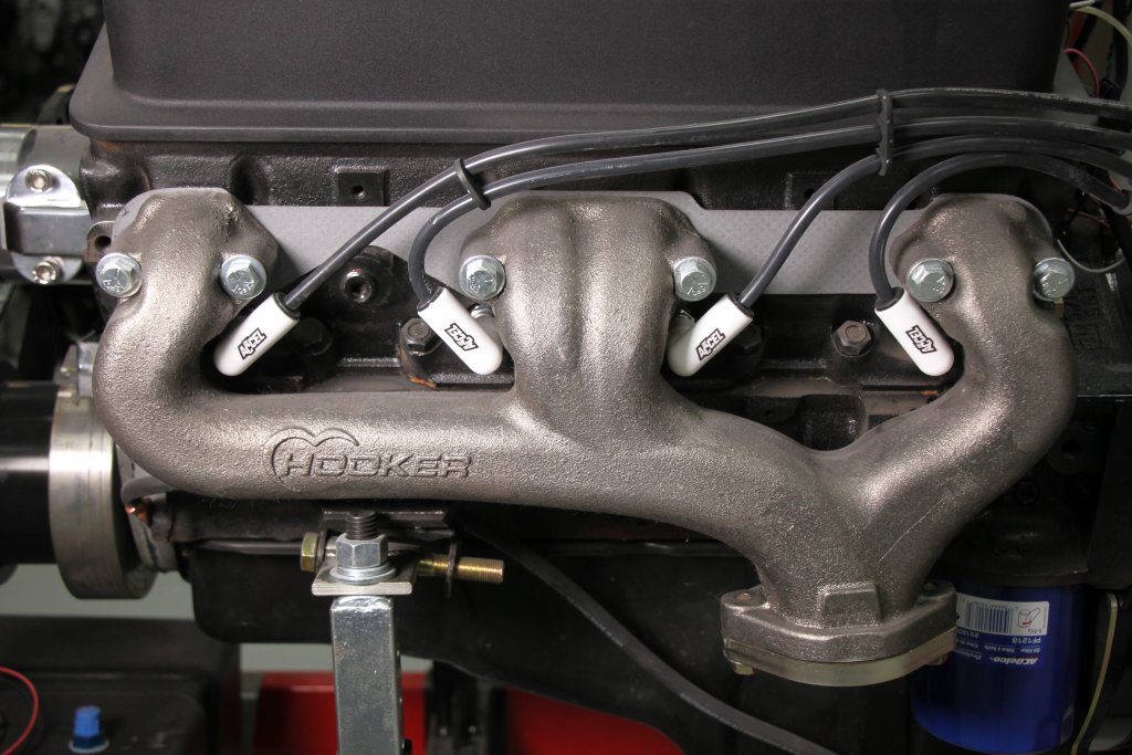

Hooker 8525. Love em.

Bought an aftermarket L side was horrible, bad threads for AIR, poor casting. Ended up sending it back. You will be better off with a used OEM replacement or those manifolds above if they make a correct set. Removing the air pump may cause other issues, don't recommend that, especially if it's O2 equipped.
Those look nice, I'll check it out.
