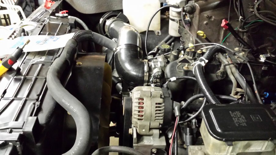

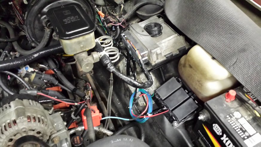

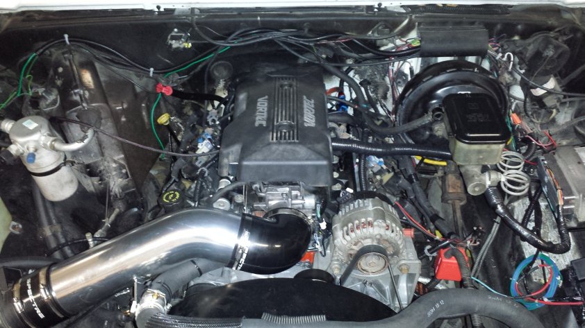

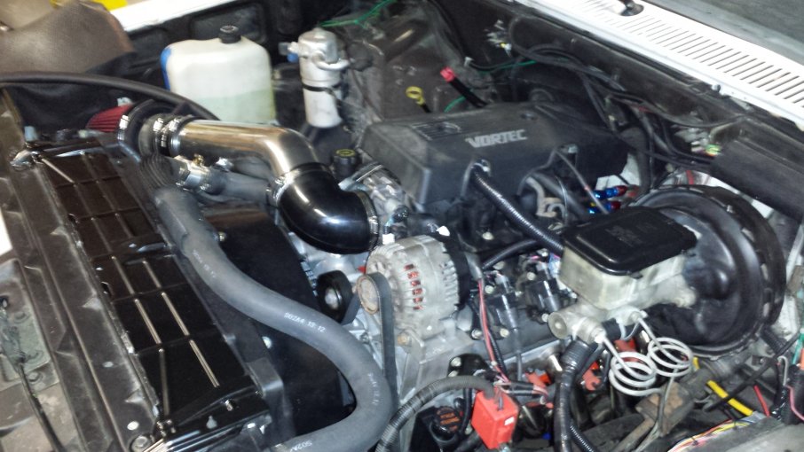

Some good news and some bad news
The good news is that I got all the wiring done and was able to here it run for the first time. It started on the first crank and idled out nicely at around 700 rpm, oil pressure was at 45 psi, and the fuel gauge appeared to reading correctly. Ran for about 5 to 10 minutes trying to bleed the air out of the cooling system and everything seemed good. Then I was checking for leaks and unfortunately spotted one you don't want to see. I saw coolant leaking from the drivers side head gasket around the #3 cylinder. That was enough excitement for one day, I called it a night. Next morning I put a pressure test on the cooling system of 10 psi and noticed a steady drip. So there's the bad news, blown head gasket or worse yet cracked head, won't know until I get it pulled off. Here are a few pics before I noticed the leak.

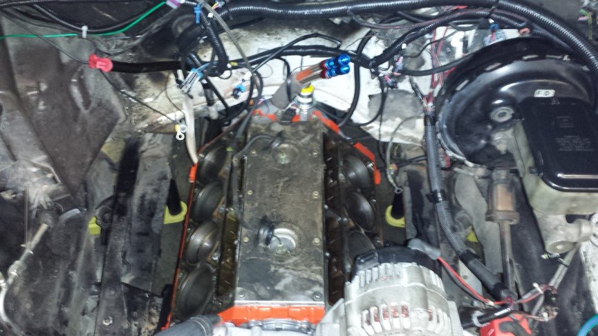

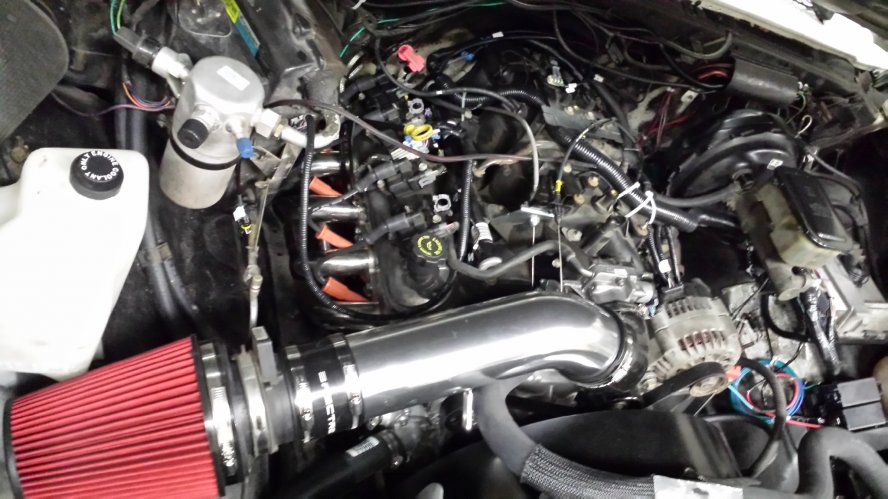

It's put back together
Bow auto sent me another head. Took both good heads to the machine shop and had them checked out along with a valve job since they were out. Went with ARP head bolts and GM head,intake, and manifold gaskets.

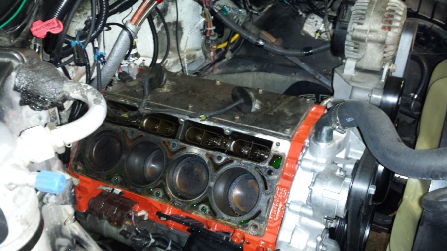

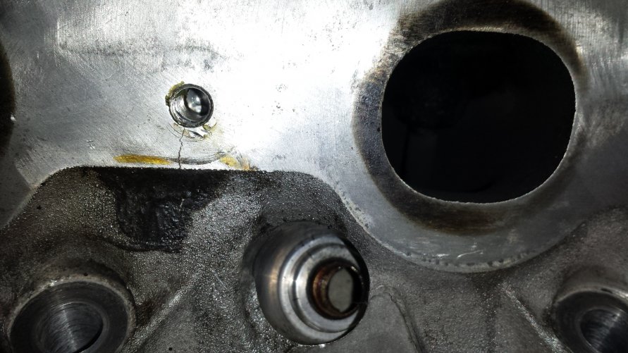

photos of the cracked head and tear down
Sorry, forgot to post the pics of it when I tore it down and where the head was cracked.

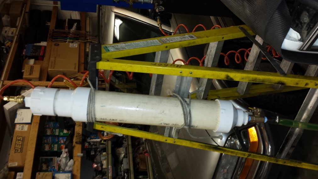

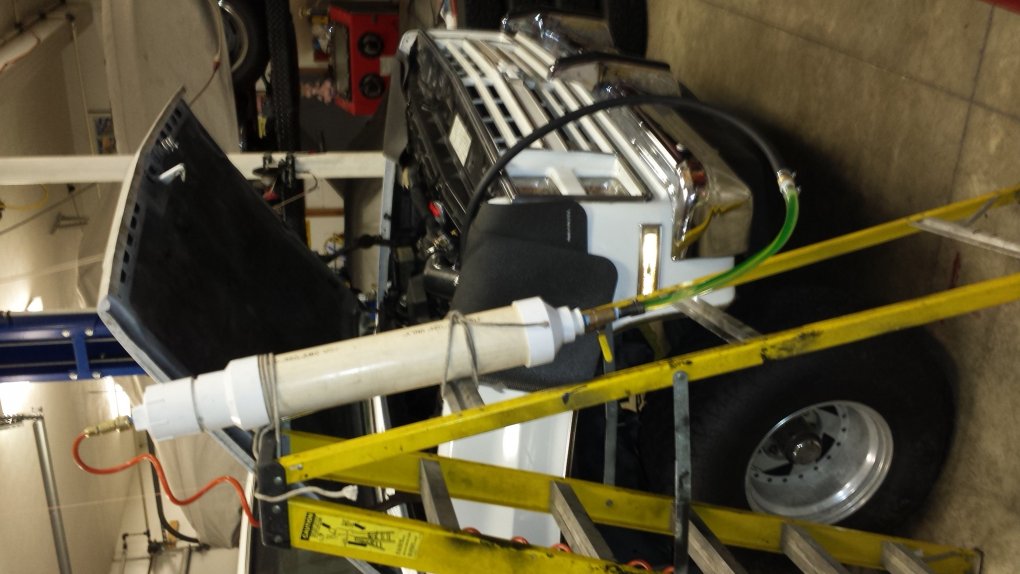

trick way to get coolant back in the block
My dad came up with a contraption to push coolant back into the block. Being that he is a retired pipefitter, this was right down his alley. He took a 4" pipe and placed a air hose fitting on one end and a valve on the other. I put a T into the heater hose and regulated 2psi going in. I filled the tube with coolant and slowly pushed the coolant in, having to refill the pipe a few times trying not to push in any air. Worked really good!

This is new two me... is this necessary?
It isn't necessary but sure helps getting coolant in with minimal air. You can't just fill the radiator to get coolant in the block, have to remove the top rad hose and start filling from the hose.
