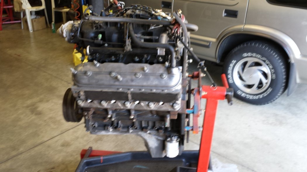

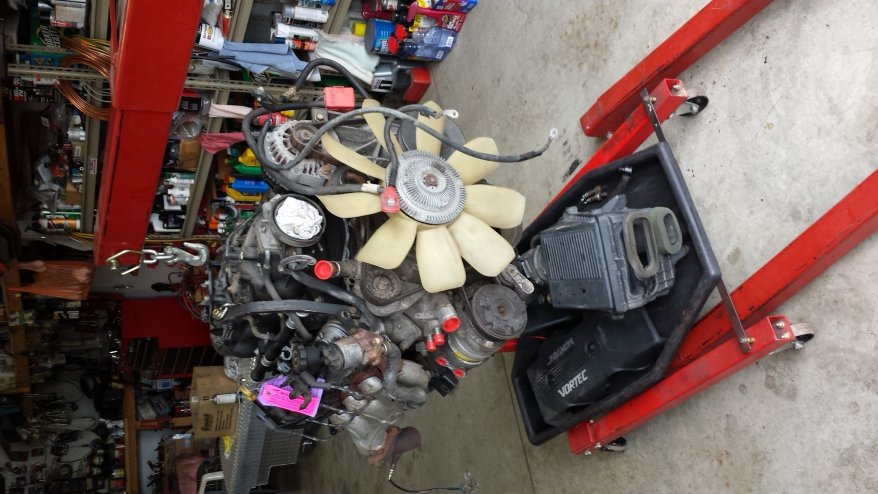

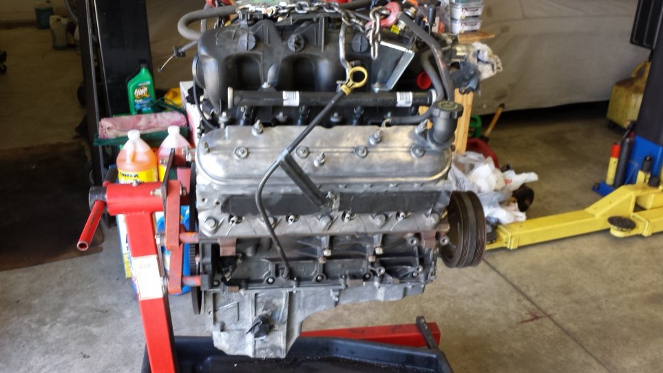

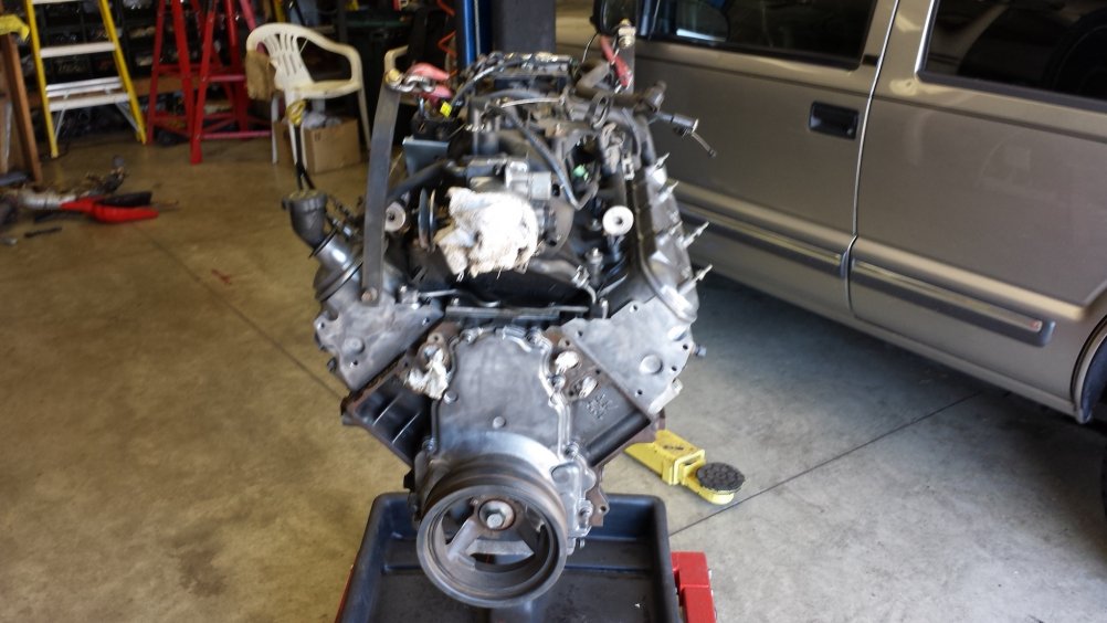

Sorry, forgot to post the pics of it when I tore it down and where the head was cracked.
were the original heads 706's? reason i ask, 706 heads are notorious for cracking. 862's are the best way to go!
Some of the 862's made by Castech are prone to cracking as well, though much less common than with the 706.

Are the 706 and 862s you speak of found on the cast iron pickup motors or are they from different applications ?
they are found on trucks. 706's crack, 862s when ported right outflow 243 heads
