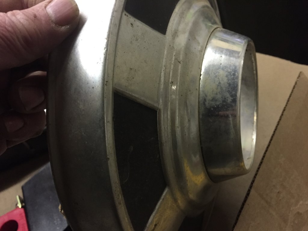

Yep. The picture for reference in the OP's opening post is that of a GM 10 bolt. Some K20's and all K30's had the Dana 60 which is a different cap. The hole is bigger to fit the larger hub and it has a 1/2" lip. Just wanted to point that out because it makes a world of difference trying to find one.
1980 k30
