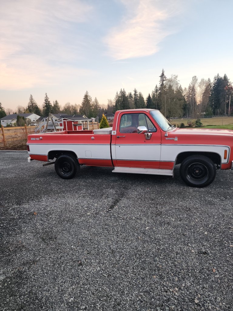

Hi All,
Just picked up a 79c10 350 bone stock and want to make some upgrades but there is so many options I don't know where to start. Here's my list of what I'm thinking as the truck does have some engine issues. The last day it stated making a ticking/ knocking only once warmed for about 20 minutes. I was thinking a rod or rocker. Engine was rebuilt in 94 but mostly sat in a garage and has about 8k on rebuild.
So I was thinking of
- headers and exhaust
- Quadrajet 4 barrel carburetor
- intake manifold
- new rods and rockers ( check springs)
Can you guys give recommendations on parts or products that works for you. Thanks

First thing is fix the noise. If just a loose rocker then figure out why. Loose from flat cam, bad lifter or other valve train wear? If in the lower end then your budget may have to go in that direction. In other words, don't put lipstick on a pig.

Thanks fast 99. That was going to be my first concern since why waste money if I need to rebuild the engine. Any tips on upgraded rockers?
1,705
2,335
Stock rockers work fine. Could upgrade to roller tip rockers but I wouldn't until the noise is diagnosed.

If your truck has been sitting for any length of time (you mentioned 1994), change the fluids, filters, and look for wear with hoses and belts. Before spending any money on upgrades, pull the plugs and check how they are burning. I'd even run a compression check. Once you know your motor is solid, then work up from there.

Gtx63 I have done all the fuilds, radiator flush, new thermostat, spark plugs and wires.

Well, that leaves the knocking noise. For an old truck that has been sitting, I use 20W50 diesel oil, with a can of Berrymens and some mystery oil in the tank. I have had a lot of old small blocks that sat for long periods, and then knocked or ticked on start up. Once they are road worthy I drive them as much as I can; daily if possible. I cannot count the number of motors that banged and clanked and smoked like a wet pile of leaves, only to quiet down and smooth out after a couple hundred miles. Rings will reseat, compression can come back, lifters clean up, etc.
The short end of the story is, don't count the old gen 1s out right away because with a few bucks and a little tinkering, they might surprise you.

I would say that your list looks like a great starting point once the noise is dealt with.
For headers, use a set for a 1968-72 Nova. They do not hang down below the frame like the truck ones do.
I have a set on my big block and they fit quite well.
Shop around for used parts as you will save money most of the time.
For example if you are just looking for a simple aluminum intake, some of us parts hoarders have 1 or 5 of them hanging around because it was a good deal that couldn't be passed up....
