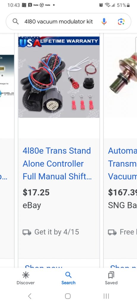

The CHEAPEST option is to pull a 4L80 from a wrecked vehicle in the junkyard, put some new fluid in it, make a full manual control for it, and send it.
For ~$50 more, you can get an 0411 computer and pigtails from the same junkyard(often from the same vehicle) and run tach and TPS signals into it from the engine to get automatic shifting. The line pressure will still be maxed out without a MAF sensor input, but you could always wire one of those up too if you wanted to get the full monty. The 0411 will run full line pressure without MAF because it can't get a real torque model without it, so it will just assume max power all the time to protect the trans. You will get firm shifts, but it shouldn't hurt anything.
