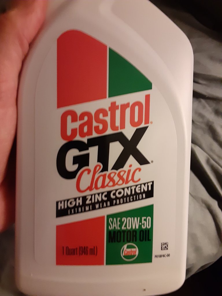

Anyone seen or tried this ?
It will be my next experiment on Goldie.

I was unaware of it. If you haven't seen it Castrol is very up front about what's in it. I REALLY like that. So many motor oils it's digging around the web for someone's test result and hoping it's accurate.
Here is the link to their info: https://msdspds.castrol.com/bpglis/...1CB34448025867E0048D3EA/$File/WEPP-BYBE6A.pdf
Says 1,400PPM zinc.
So at the shop we are stocking Valvoline VR1, which is available in 10W30 & 20W50.
The Castrol Classic seems to only be available in 20W50, I'm not sure I'm 100% happy about that. I'd like to see a 10W30 as well.
I'm back to using the diesel oil in my truck again, and I have to say I rather like it.
I hope you'll report back if you notice any changes when you are running the Castrol Classic, do you remember the price?

I think I will put it in tomorrow.
$ 22.47 for the 5 quart jug at Wally World- I think the spare quart was 5 something.
Something I just randomly saw today and grabbed.

VR1 is $32, in a 5 quart jug. Oreilly's brand 20W50 is $22.99. Wow that's a good price for the Castrol classic! Def keeping that in mind. I'm pretty happy with the diesel oil, but always like the idea of more protection, especially affordable ones.

One day of highway - almost hitting 40 psi on the freeway in ~ 95 ish temps with the A/C off, and hot idle around 25 - 29 psi, so higher than what it was doing.
I am curious if it will lose less oil, but, not going to bet on it.
If, for example, my problem is an intake manifold gasket then I don't think weight or the zinc content is going to effect that.
:anitoof:
Oh - I basically have 4 quarts of the 20W50 and 1 quart of 10W40 semi syn as I had changed the oil filter last change after about 200 miles to see if that had an impact on the oil pressure.
It did not, but I was not going to waste a good, slightly used AC Delco PF1218 with good oil so put it in a closed box until I used it last weekend.
So, maybe I am running 16W46 oil ?
:Big Laugh:
