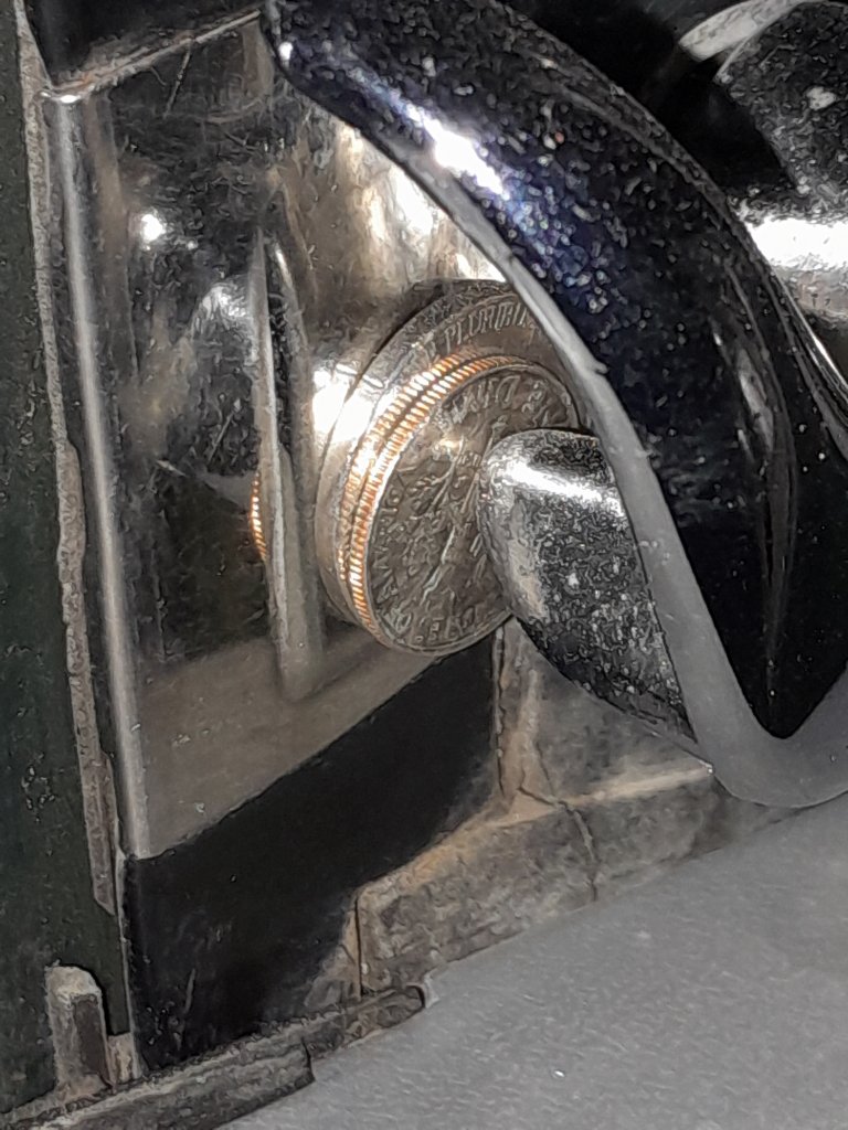

My passenger vent window has wind noise. Putting a cardboard “shim” beneath the vent window handle helps.
I run $0.15 in mine - works GREAT!
sounds like the division post run channel thing deflects from "perfect" if it has to be shimmed but i am trying that out on my f150. dumb things have seals that literally shrink to barelly being long reahch what it seals
