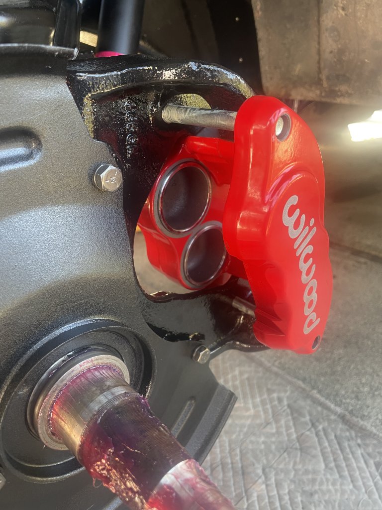

Hello, I’m new to this form and joined because I’m having issues with my new Wilwood D52 “direct bolt on” calipers.
Here’s the issue. The calipers fit with the rotor and the pads off the truck/ spindle. However, with the rotor and the pads on nothing lines up. If I leave the rotor on without the pads the caliper will bolt in place.
So now I’m thinking of cutting or shaving the spindle to make more room for the brake pads.
Has anyone had this issue? I’m kind of uncomfortable with cutting the stock spindles. If not I guess I might just put the stock calipers back on.

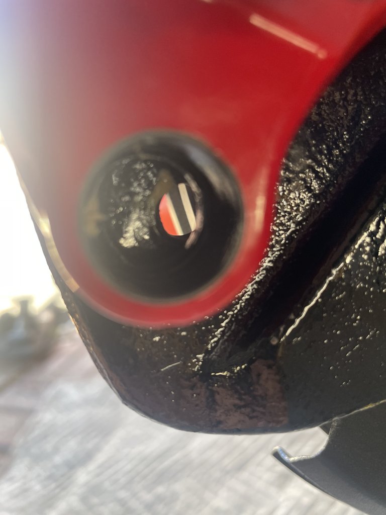

Hey Jess, is this really what I see? Does the bolt hole misalignment not allow the pin to go in all the way?

That’s right! And the lower bolt won’t fit at all.

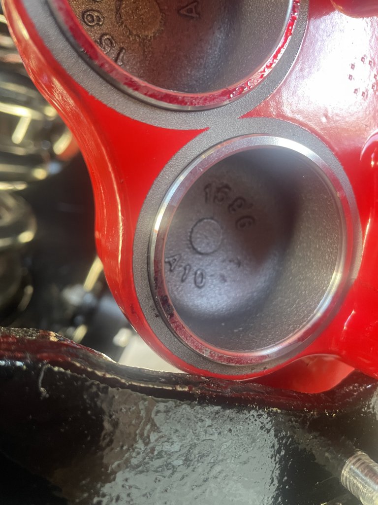

I wondered if that powder coating was too thick somewhere. Are the rubber bushings seated properly in their grooves?
I ask, because it seems really hard to screw up a square body caliper. Is this a single pot caliper? I ask because brother put two pot calipers from wilwood on and I never heard a complaint yet. Not to say that a defect casting didn't made it all the way out, post covid everything is a gamble in the quality department.

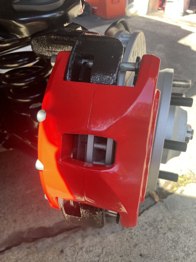

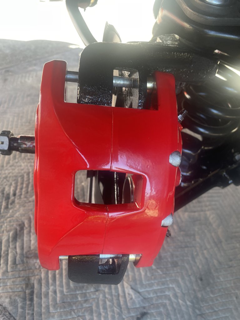

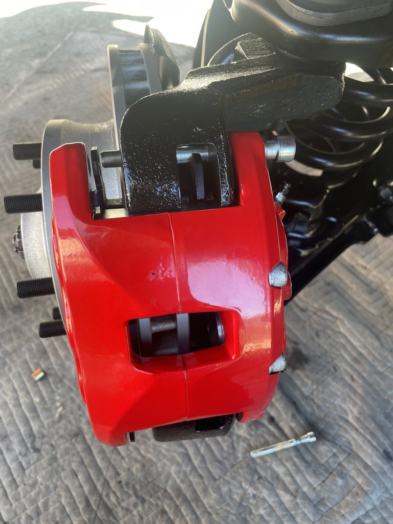

Here’s the caliper bolted. Do you think the pad is getting held up on the spindle with the brake pad?

What rotors are those? That is definitely not a factory rotor setup, did those come as a package from Wilwood? The rotors could be your whole problem.
