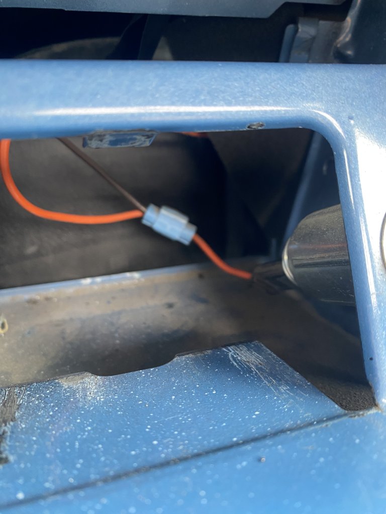

Does anyone recognize this plug? Seems to tee into the wire powering the cigarette lighter. I’m not sure what it goes to. If anyone recognizes it, let me know. Everything seems to work fine.

Maybe for a constant hot wire for an aftermarket radio.
