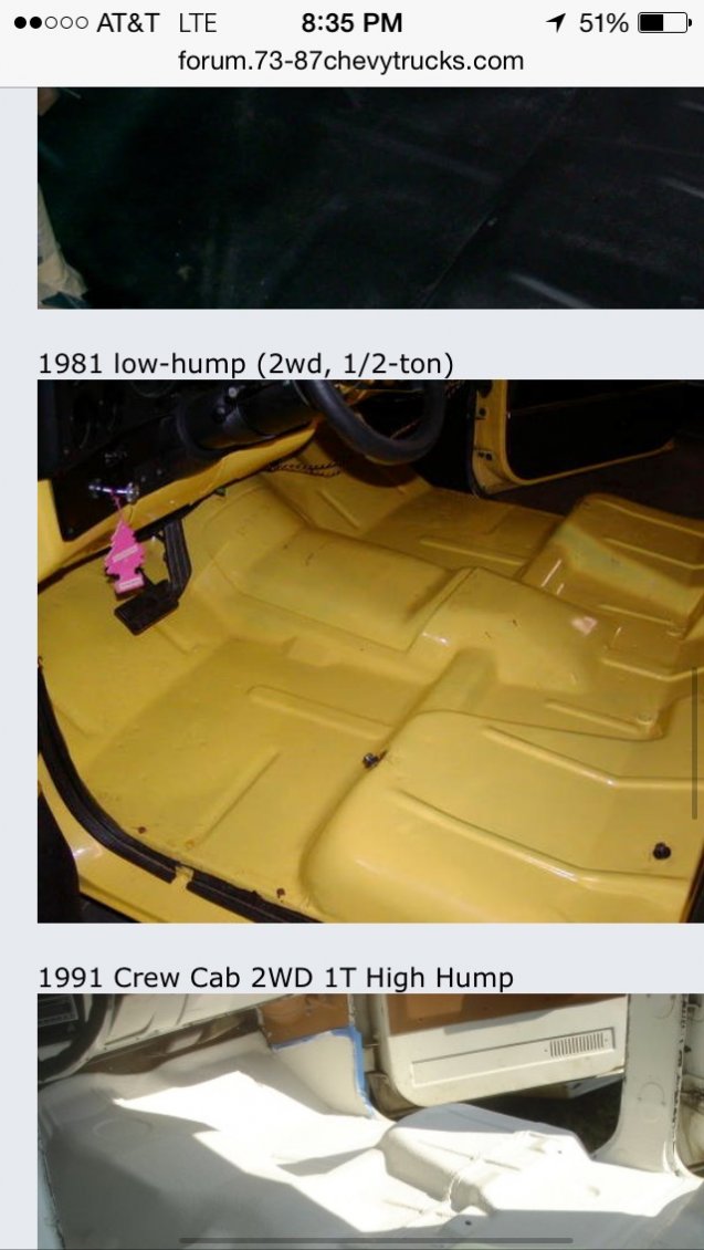

What do you guys think about the height of the hump? It looks kinda low to me. My vote is a clean 2wd late body on a 70's 4wd frame. Maybe... This is crazy..
CSFJ
Jul 1, 2014
6,160
5,175
You're probably right on the money. Looks low compared to the pics in the link to the other thread.

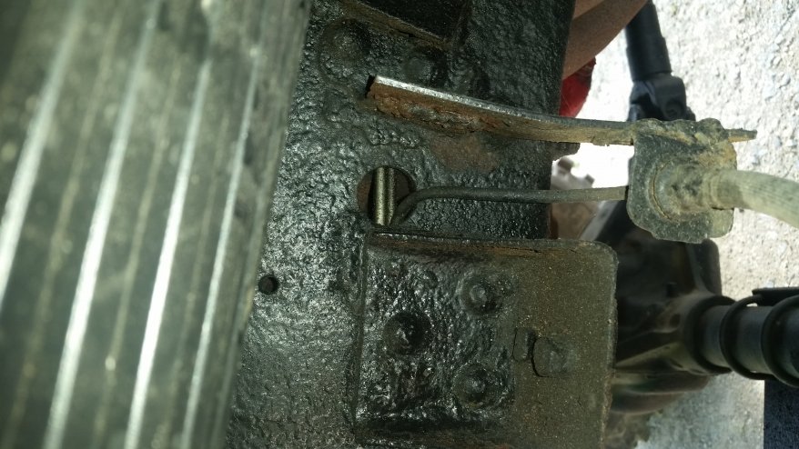

I'll add a few more pics for people to take a gander at. Here is one of the brake line through the frame.

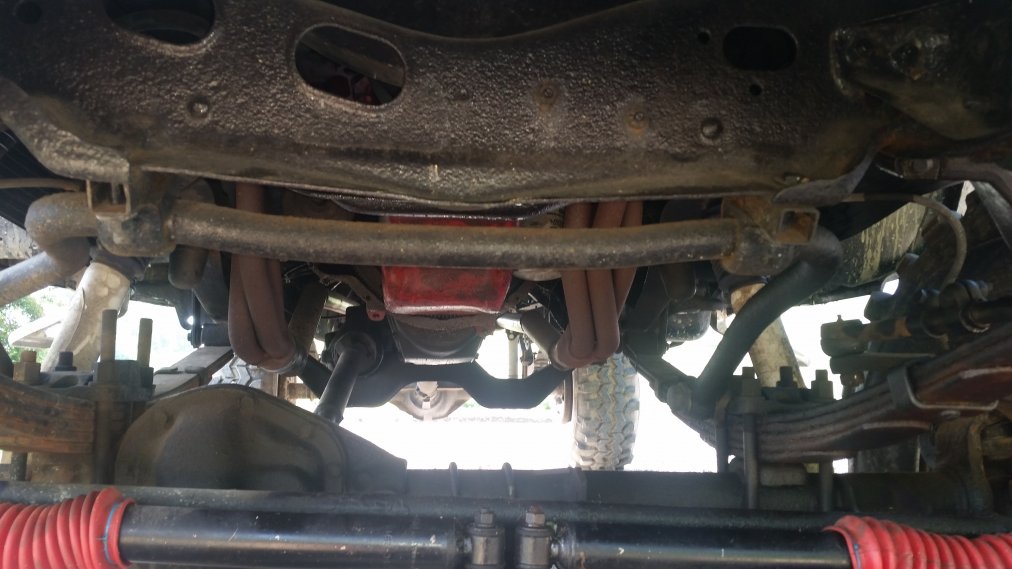

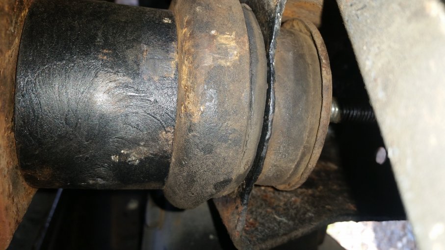

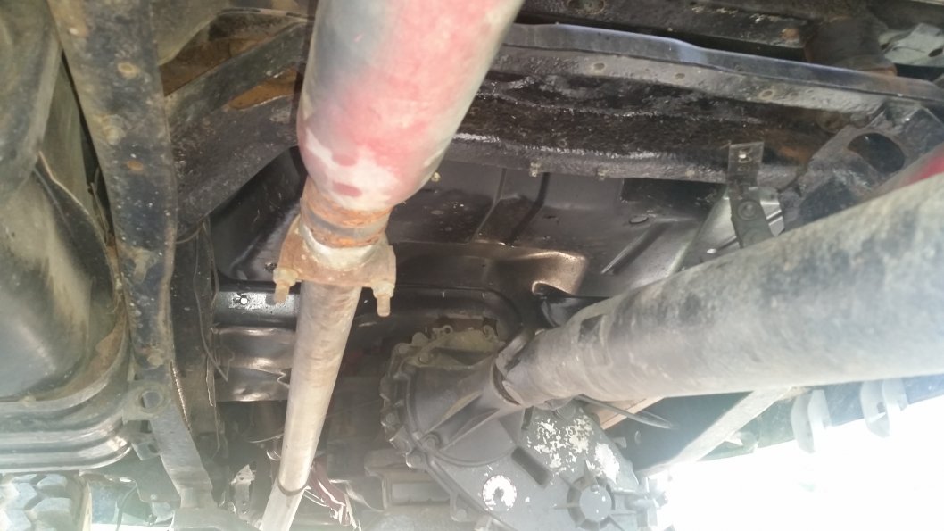

Here is one of the front mount and just a couple of underneath the truck
