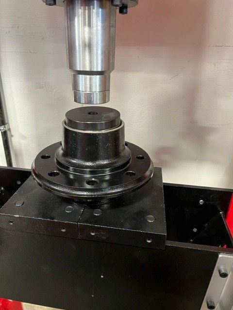

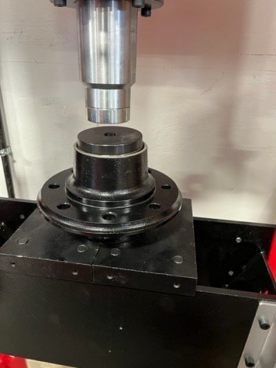

Have wanted a press for years and finally got one. So far I really like it.
I don't know why I didn't buy a press years ago. No beating in wheel hub races!

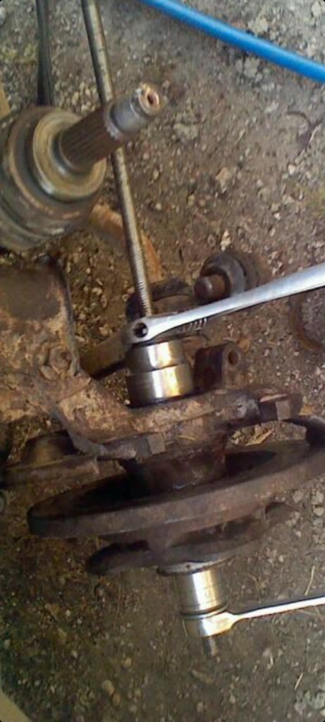

Me doing races on the car,no pounding. Done with junk we all have laying around. 2 sockets,2 2 washers,2 nuts 2 wrenches and a piece of all thread rod to pulll everything together. You can leave the hub on the car saving time and labor. It's even easier if you freeze your races and warm the knuckle with a propane torch.
