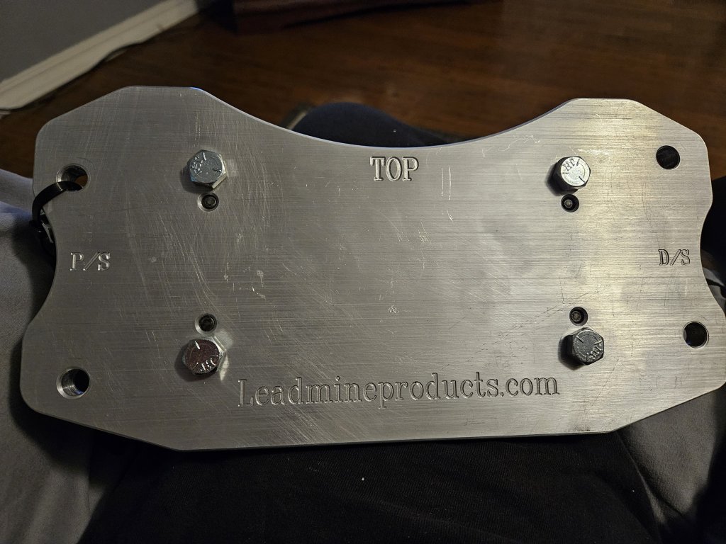

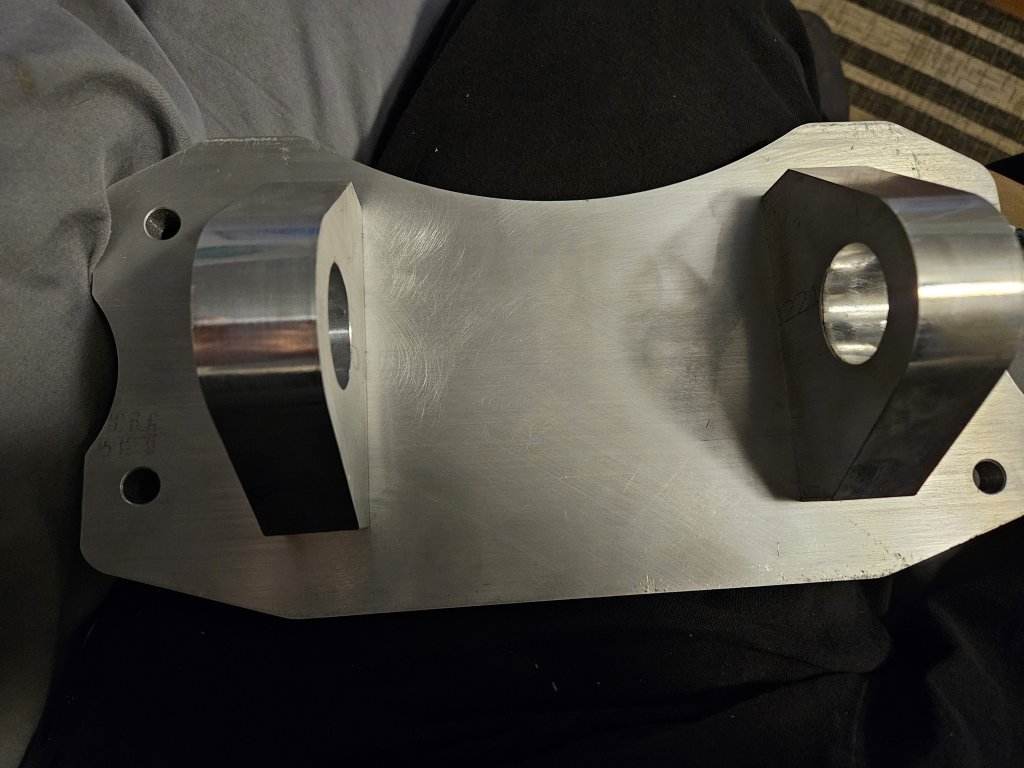

Just got this in the mail. Centering jig for narrowing a Ford 9 inch... getting ready to cut the rear-end down for the 82 2wd Blazer.

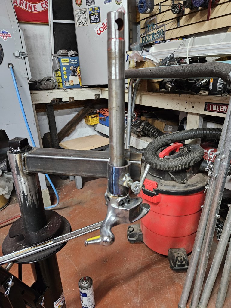

I've had one for decades, as is,it's junk, if you can weld you can make a better one. I've upgraded all kinds of stuff on mine,just to make it functional. The bead breaker doesn't work 90 percent of the time so I had to adapt a bead breaker from a different manufacturer. The mounting bar. Ha forget it, it dismounts fine but you will be prying your new tires on with tire irons.. Mine is very functional now but it is no where near what it was when I got it. Now I can break a bead everytime,dismount a tire and remount any tire without having to pry them on. I'll try to find pics and put up comments so this will be edited a bunch. Keep checking back. Okay could only attach 5 pics,I made probably 6 different mounting bars none worked great. The bike carrier,turned into duck head works best. The bead breaker is a Speedway wide foot bead breaker,with back bar removed and a piece of chain and strap to replace the back bar. The round wheel looking pic with the hook is a pic of the head of an old Milton tireman tire bar,I bought, it works decent,duckbill on a stick,way better than the harbor freight bar. The bulldog tire lever,absolute junk,140.00 dollar junk. So the only part of the harbor freight tool I use is the upright. I've drilled holes in the round plate to bolt my wheels down. So if I were to start all over, I'd take a piece of scrap pipe weld a plate on bottom to bolt it down and a plate in the middle to bolt wheels to. Then I make a duck head mount and buy a speedway bead breaker. P.S. it was on that wood when the previous owner threw it away,because it was junk.

Yep,I think a brake drum would work,or a rotor from a hub and hat style rotor and hub.Id be half tempted to dig a hole like for a fence post and just set it in the ground in concrete,weld a plate to bolt the wheel to,done. 1 would drill 2 holes all the way through the pipe close to the bottom 90 degrees apart to stick pieces of steel rod thorough. Stick the rods through( cut off chunks of old factory tire tools) that would keep the pipe from twisting in the concrete.

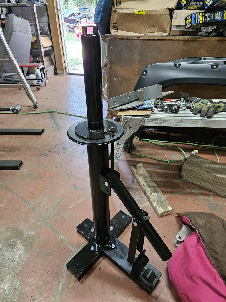

Got these for Father's day. The 7 inch grinder is a beast. Yes got the HF tire changer... I'm going to upgrade it. There are some good upgrade tips on YouTube.

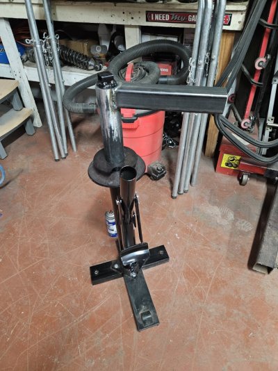

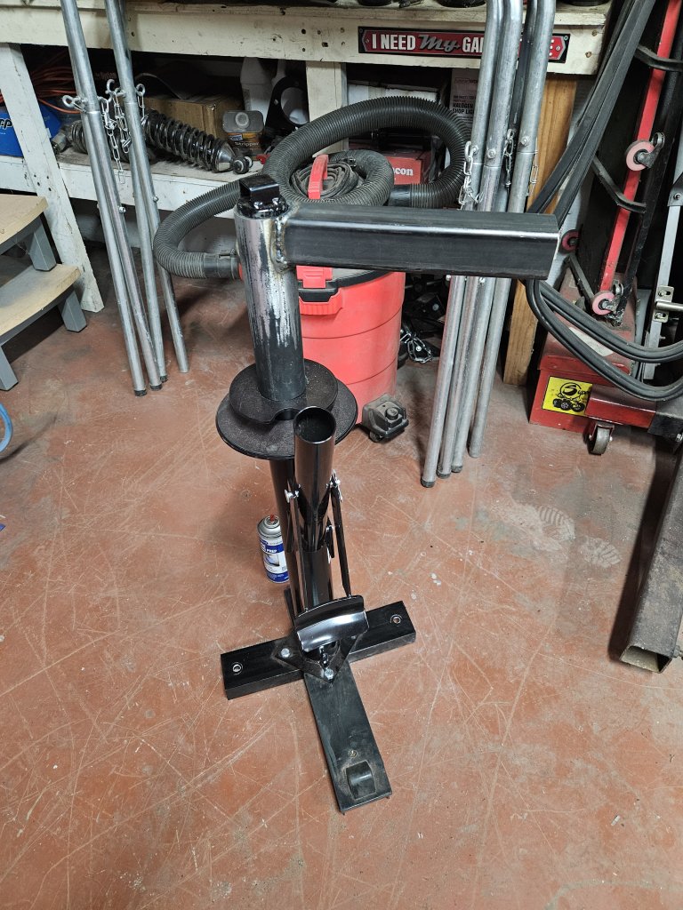

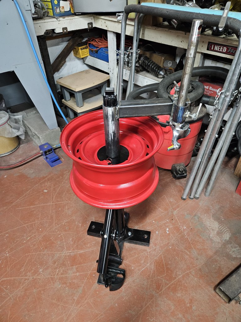

Started upgrading the HF tire changer.
I was happiest drilling holes and bolting the wheels down. They stay in place better and you don't have to worry about scratching them up. 2 bolt holes for 4/6/8 lug wheels 3 for 5 lug P.S. the slotted hole where the pin went I use that as 1 hole then another straight across for 4/6/8 lug 5 lug I use it for one hole then another left or right and one splitting the difference across from those 2.
