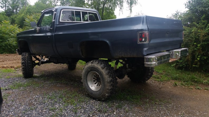

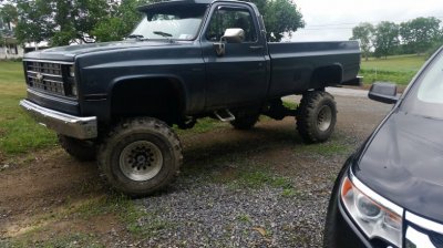

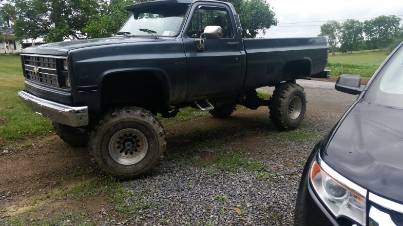

it will be easier if you take picture.
mooman929
Jun 15, 2015
60
danville, pa
Ross
355
Here it is
marks86
Feb 2, 2011
1,513
90
Latham, NY
Mark
12v Cummins
I think that's a 10" lift .I run 6" lift with 37s and my tires fill out the wheel wells a ton compared to that
firebane
Jul 10, 2014
1,732
30
Calgary, AB
Curtis
LOL the bottom of the body sits flush with the top of the tires.
No wonder that thing rides like a 2x4.
