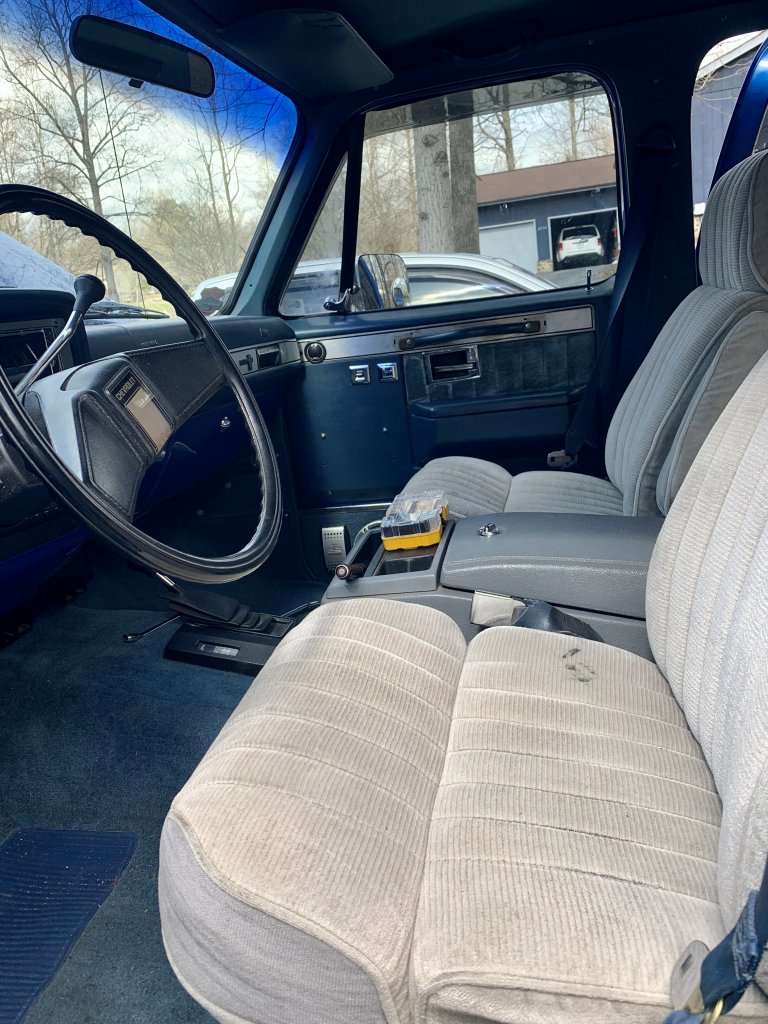

Last weekend I pulled the bench and bolted bucket brackets in. Installed buckets and center console.

What's the seat out of and the seat brackets home made or available

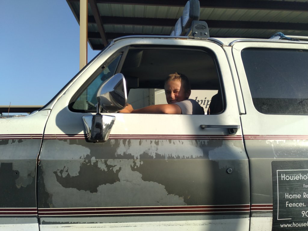

Gave it a bath and removed the roof rack because it needs a fresh coat of paint. I can't decide if I'm going to put it back on though, it's handy for hauling home bulky items like lumber but it's a pain to wash the top of the truck with it on. I'm guessing it also causes a 1-2 mpg penalty in fuel economy. Guess I'll leave it off for now and think about it.
Nice! Enjoy seeing my stock colors looking so good lol attached is an up close of my current paint and whats left..
