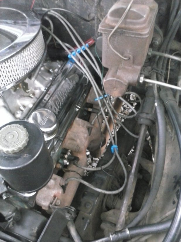

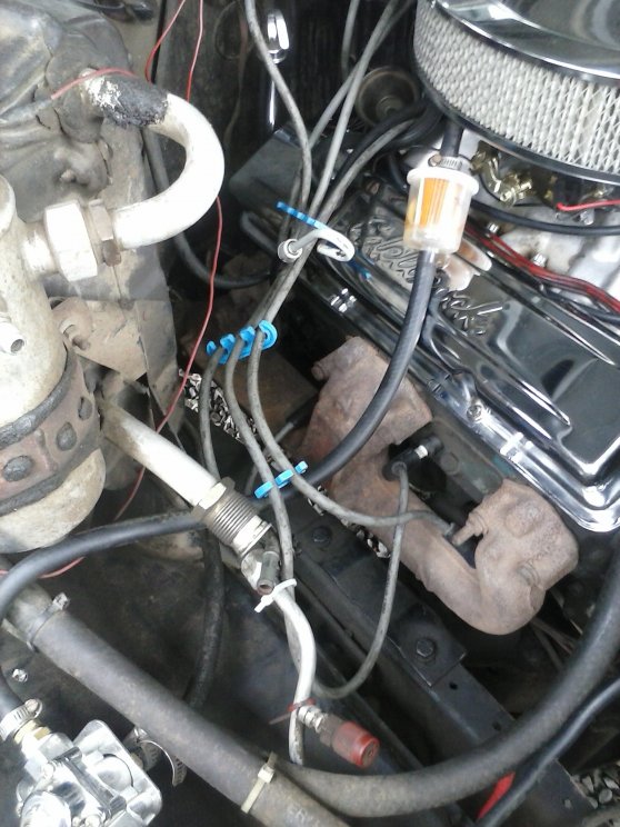

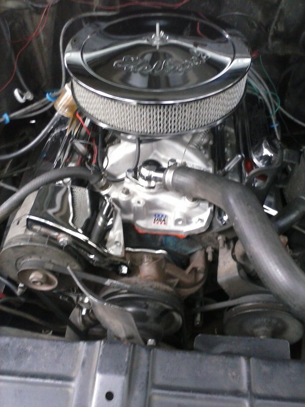

Done a number of things today
put a tachometer on, put a chrome alternator bracket on, put some spark plug wire separators on,

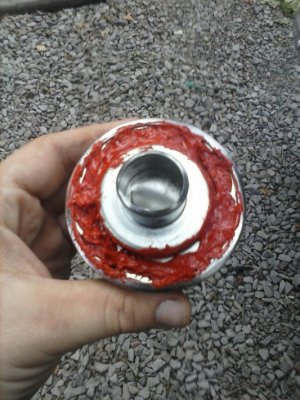

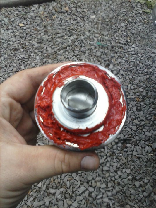

and finally fixed my chrome push in oil cap it was leaking out oil vapor onto my valve covers so what i did is plugged all the little exit holes with rtv silencone
:rofl: I'm not so sure that plugging that vent cap was a good idea brah !!! :happy175:
The reason that cap is leaking is cuz you prolly have some blow by in the motor. That cap is to vent the blow by and yes, it's possible in extreme conditions it'll puke some of the oil out of it. If you have blow by, it needs to get out of the motor somehow. It will find the path of least resistance or make it's own path. If you plugged that off real good and nowhere else to vent the blow by, it can blow seals out of the motor and will be the weakest seals first.

A faulty PCV could be causing the oil vapor too.
Smearing RTV all over the breather will likely cause a leak somewhere else.
Good Point about the PCV. And yeah, that's my point about plugging the vent cap. The blow by WILL find a way out, or it will MAKE a way out.
Sure is a purdy motor to be having blow by.
would there be someway to stop the blowby. i replaced the pvc valve thinking that would help and it didt
also is this a very serious problem. this engine just needs to last me till i get the cash up for my new engine
47,200
9,468
Blow by is USUALLY caused by worn rings, or very well worn valve guides where the compression is escaping the combustion chamber and into the crankcase.
What you might be able to do... You ever seen those tall oil fill tubes on valve covers? If you can find one of those, then use a vented cap on the top of that tube, then mainly just air might escape and oil may not make it up the tube all the way and drain down the tube wall back into the top of the heads so you're not losing as much oil.
But, you do need to vent the crankcase somehow or you'll blow more oil seals. You can't build up to much pressure in the crankcase and if you block off all the vents and the PVC valve isn't enough, then that's what will happen.
