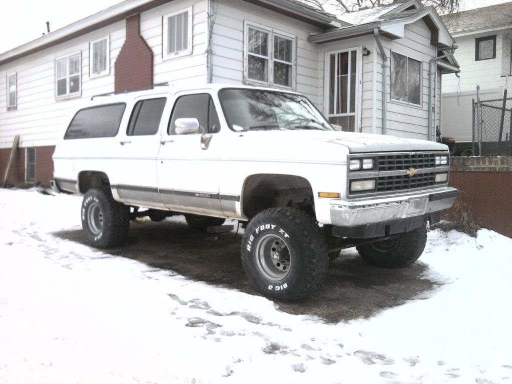

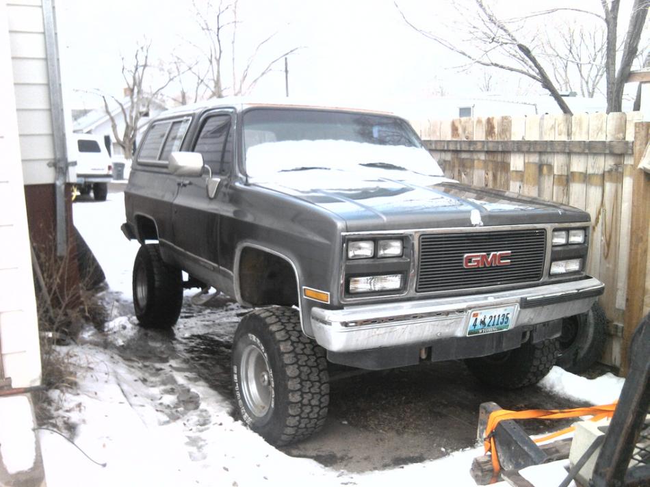

well i decided to resurect a old project and maybe in the process save a defunct project of mine as well
i decided to pull the freshly rebuilt 700r4 out of my 90 sub and put it in my 90 jimmy. i got the tranny out of the sub and now i need to pull the one out of the jimmy and put the good one back in it
i was building the sub and changed my mind on what i wanted before i ever even got it running i decided my crew cab is what i wanted instead
i have the 88 sub that i am taking the interior out of for my crew cab it has a great running tbi 350/700r4 that i think i will put in the 90 sub and make it a driver
i am trying to combine trucks and end up with a couple god running dependable rides out of it
