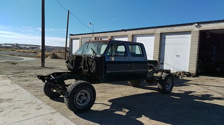

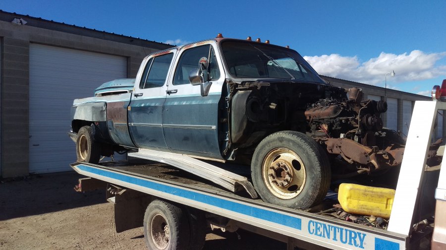

this is what I started with had a engine fire

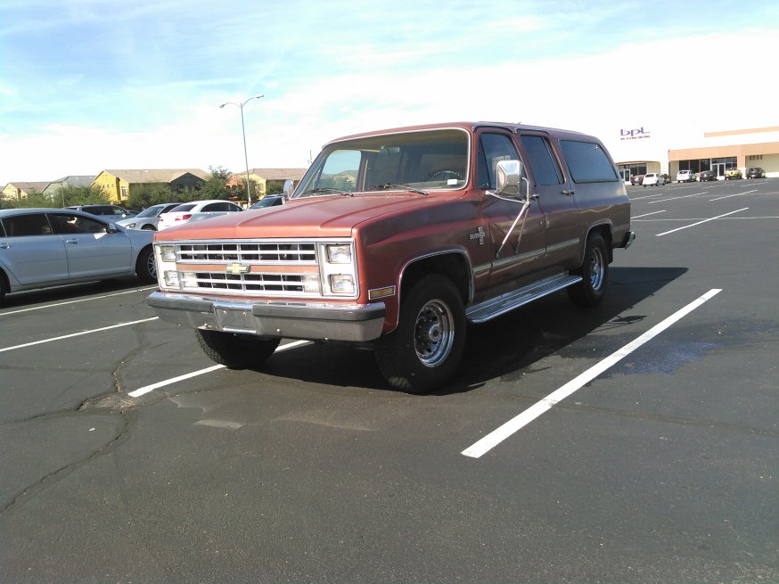

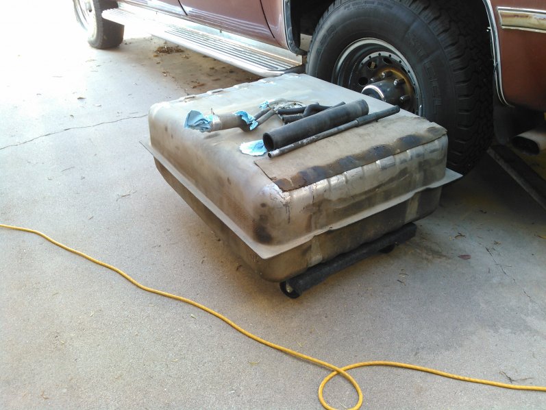

Back on the road and through emissions yesterday after a year and a half as a driveway ornament. I have replaced the entire fuel system at this point. Need to tune it for driveability some more- seems OK but pretty sluggish compared to how I remember. Made it through emissions with good numbers, but that's a whole 'nother story.
Found the culprit for my previous intermittent fuel pressure issues... Sock on the sender had fallen off and it, along with a bunch of other random debris, were probably clogging the pickup on and off. Also had some REALLY deteriorated hoses back towards the tank. Holding steady at 6psi now, had been at 2 - 4 psi before all the work.

Huge conversion! C3500 Crew Cab Long Bed Dually to a K3500 Crew Cab Short Bed SRW!
Major props to ya for taking on that project. Super cool. Especially those 8 lug 5 slot mags!

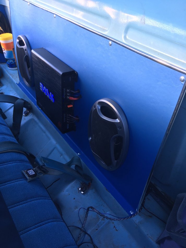

Upgraded the sound system.

Is the seat up against em i want to do a small 10inch sub and amp maybe 6x9s and some new front speakers
With the seat all the way back there's a gap of about 2"

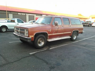

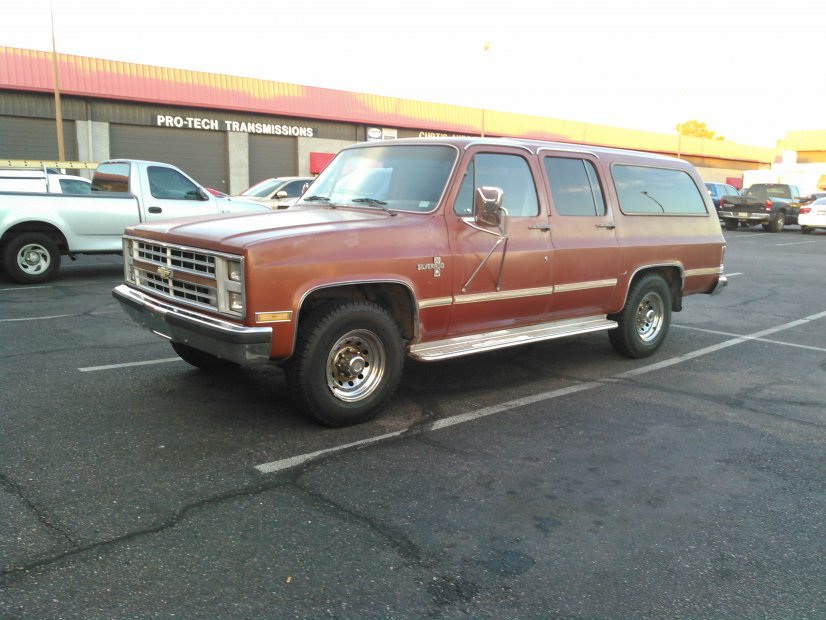

New shoes on the 'Burb today, got a deal on a set of Cooper Discoverer RTX tires, HUGE improvement over the Pathfinder ATR tires that came off. The old set was date coded 2002, and was rock hard and cracked. I noticed a new softball-sized lump and bad sidewall cracking after driving to work yesterday, so it was straight to the shop this morning.
