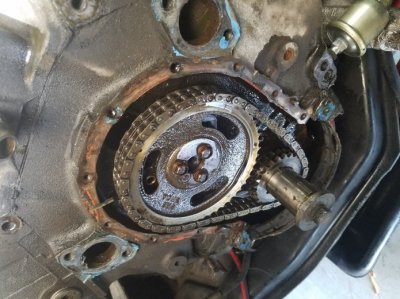

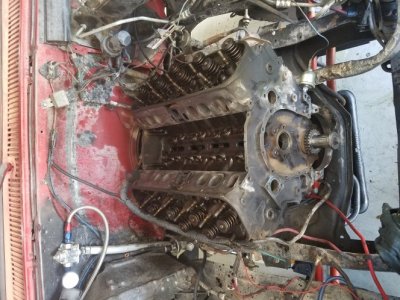

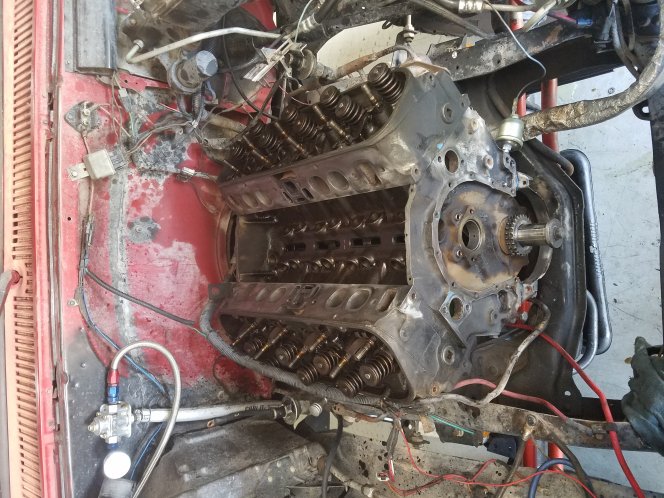

Started this today cam swap. Chain was sloppy cam had a wiped lobe and distributer mechanism was locked up. No wonder it ran like dog doo. Finishing up tomorrow hope it takes new cam well. Ill post a cam pic tomorrow its bad.
Thems ain't no peanut port heads !!! You going OEM cam spec? I think I'd at least go RV or step or 2 over. Though no telling how tired the bottom end is. Oil pressure good? :shrug:

Ya i put a performer plus rv in it. with new lifters New chain comp cams roller tip rockers push rods edel water pump. At idle it has about 30 oil psi running down road about 45 50 psi. The heads say 236

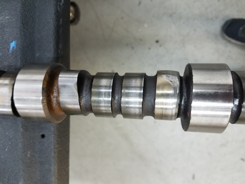

Heres the cam

Got it up and running. its like a new truck so much better more power, runs smooth no valve train noise.
