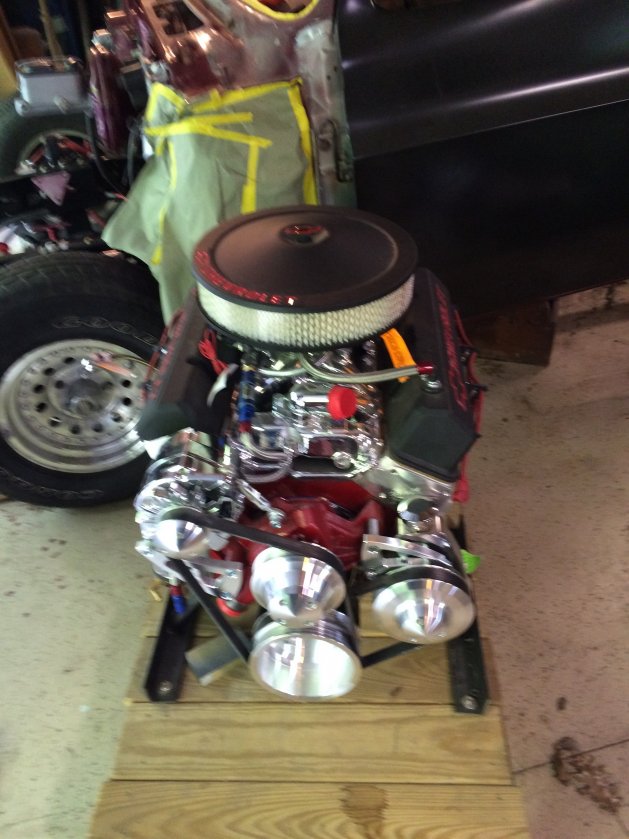

[here are some pics of my 75 scottsdale 2 wheel drive lowered 5/7 with a static drop.
This is what my wife got me for my retirement gift. Great Gal
