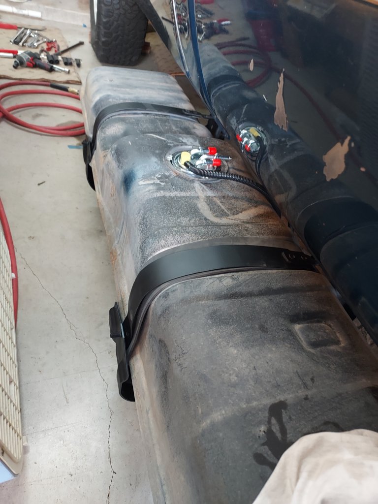

So I got under and found that the catalytic converter is directly in front of the drivers side front tank strap. The rear strap seems to be easily accesible Please see first 3 pics:
Yeppers, I had the same problem.
So, I assume you took down the poly cover.
I loosed back strap some, so it's not poking through the frame. Removed all 8 bracket bolts. I supported tank with a trans jack whatever will fit...got the front bracket away from the frame enough to get a 18mm wrench on it from below, to loosen some. Problem for me was that front strap bolt got hung up over frame. Little pry bar and shimmy shimmy. You'll get there.
Sgt Gus
Aug 2, 2023
523
938
Mark
87
R20 3/4 ton
454ci/7.4L
The front drivers side sits above the frame, thus no hole (in frame). I can't get to (tried a lot) because the shield for the cat is there. I used pivot etc extensions bla bla.
Removing the poly shield did give more room to move the tank, but not enough and strap thread hung up over frame. Loosened with wrench and pry bar to koax tank came down.
Exactly to your statement. I may use a sacrificial nut to not damage the new one I'll leave on, even run a die if needed. Seems PITA. Passenger side should be better.
Driver Tank up, ran it for it's 1st 10-15 minutes. Front bypass fitting started leaking a drip. Daughter's like "something getting on the winshield".Shut down and started tightening. Yikes. Engine definitely got up to 210°. It was so exciting to run the 1st time.
