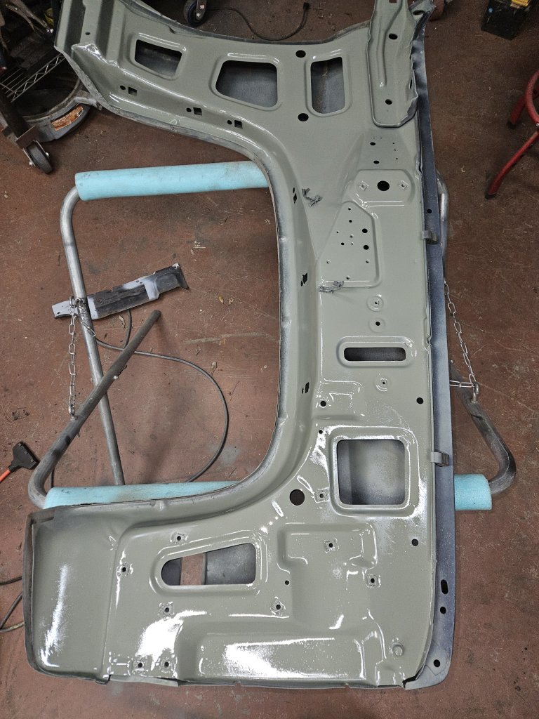

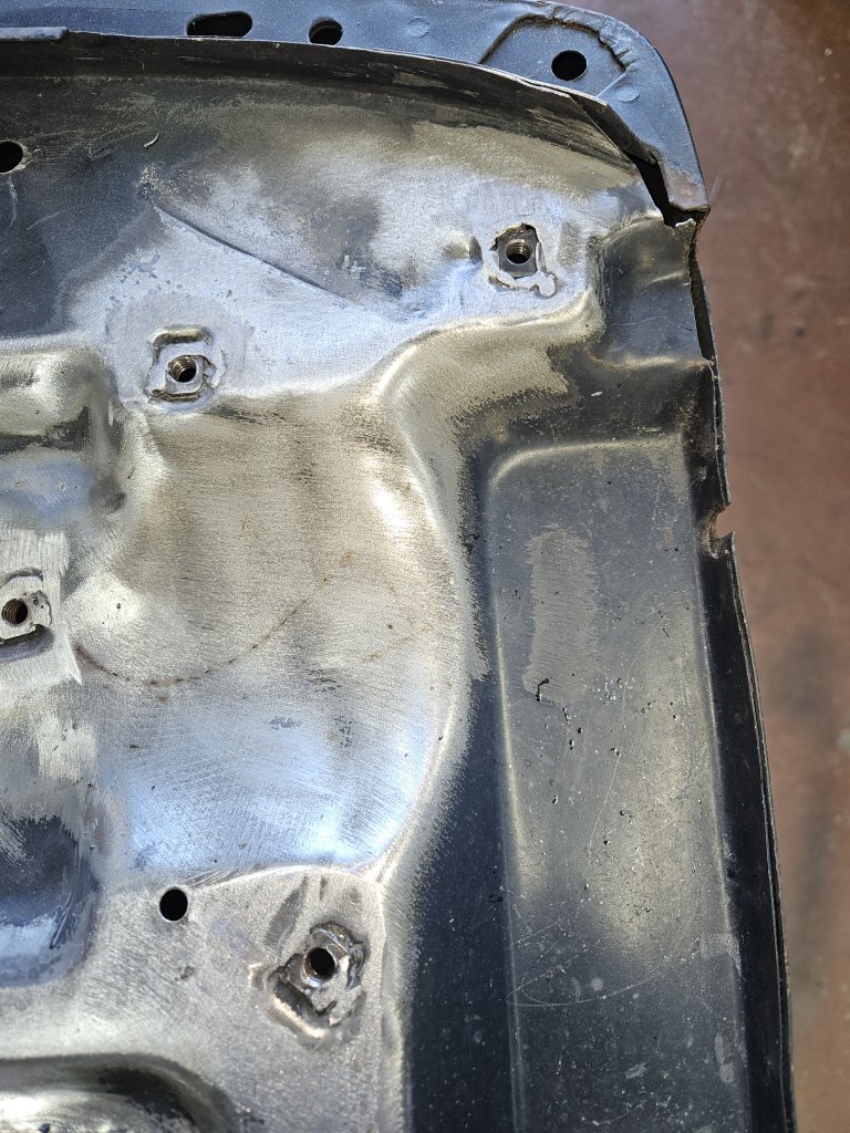

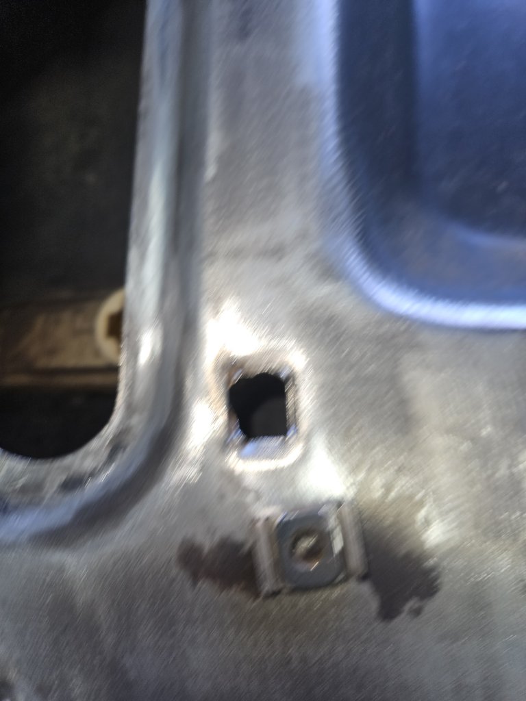

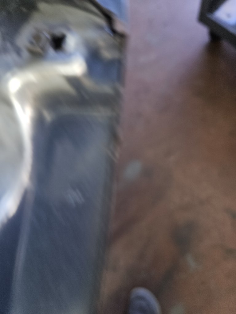

Got the welds mostly ground down so a thin coat of body filler will make it look like it should. Shot some self etching primer on it so it won't start to rust. Started cleaning up the driver side in side fender. Had to weld in a couple of square nuts for mounting to the core support. Also found a dent on the face of the fender. Finally got to use a tool I've had for a few years, just haven't had the opportunity to use it. Never used a stud gun before, there is a learning curve...lol
