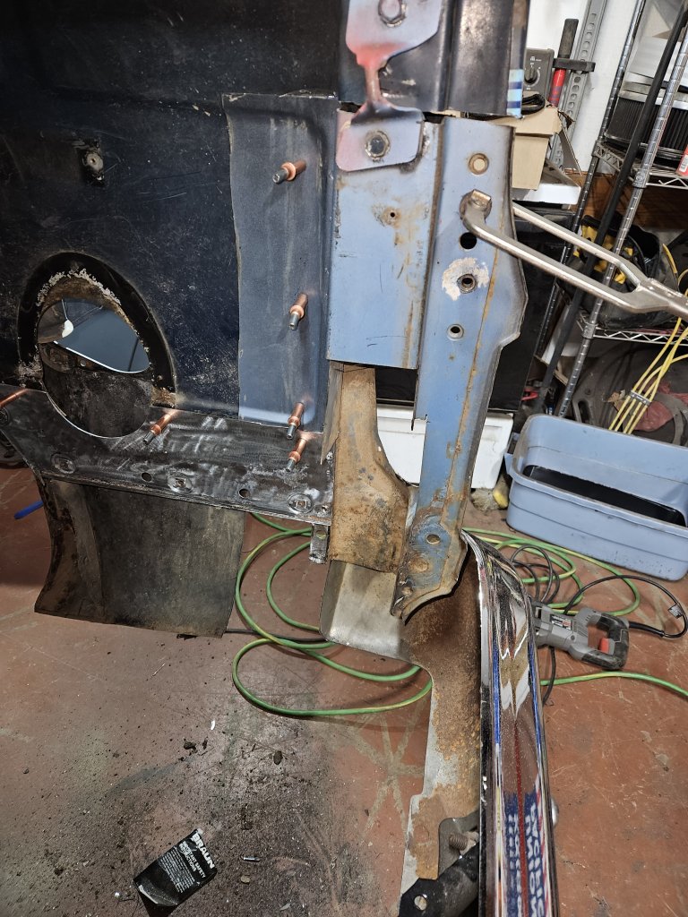

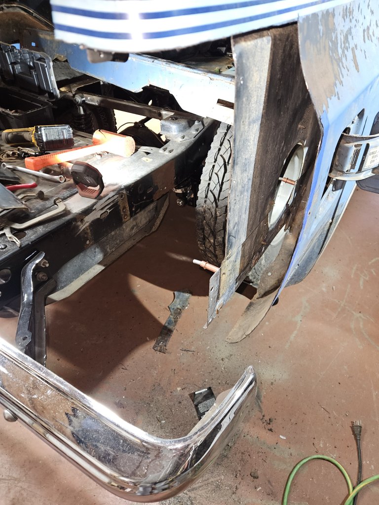

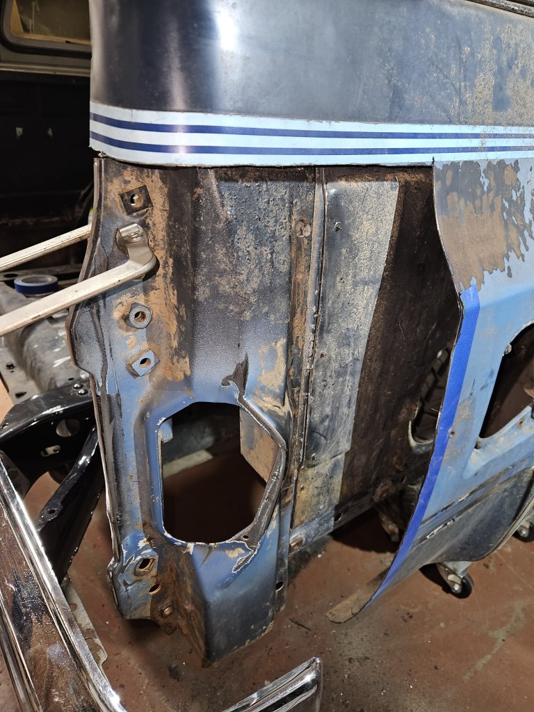

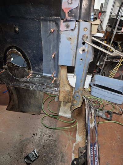

Cut off the rear portion of the taillight, and all of the rot. Started welding in a better section.
