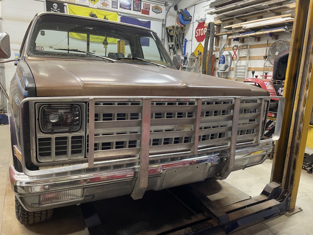

I finished installing my vintage auction find, an original bush guard. It required fabbing a new mount as one was poorly repaired years ago. The grill guard has signs of a tough life.

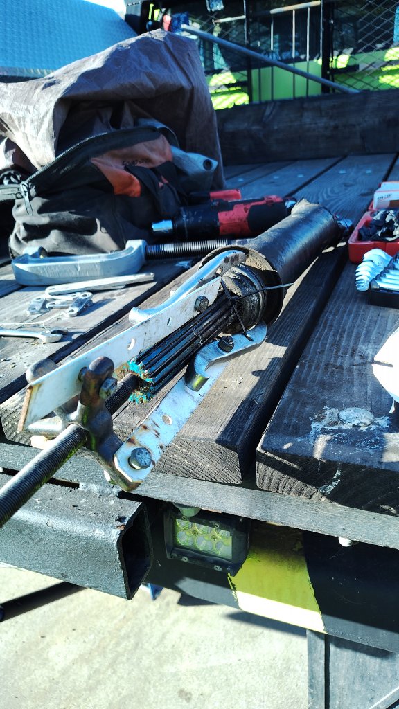

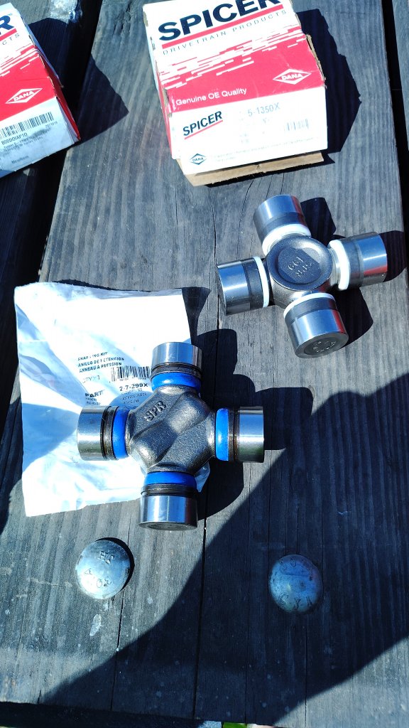

Finally getting around to doing the rear u joints and carrier bearing first off one of the 1350x joints I ordered was wrong and I tried to modify a 3 jaw puller but it didn't work so I just overnighted a bearing splitter to hopefully save my self from having to cut the old bearing off lol

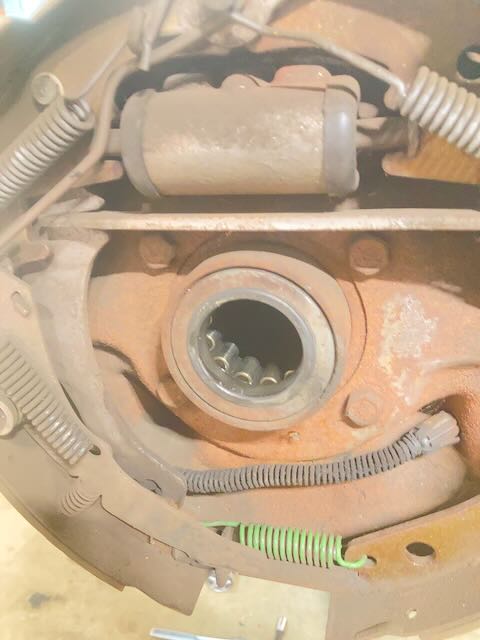

Fixed my brakes without actually touching them. I had a problem with High speed braking (in rush hour traffic that jams up suddenly. Hit the brakes and the rear end would try to come around. My truck is a 250-6 manual with manual not assisted brakes. Long bed, and usually empty.
I had a slightly bent rear axle (from an accident in 2005, by previous owner). When I replaced it... I pulled the axle out of the brakes, replaced bearing and seal, and slid new axle in. Only had to slide the drum off, and then reinstall. Never touched the brakes.
Now, Braking is solid and truck responds amazingly well considering how light the tail is under braking.
That little bit of wobble in the axle was pushing the brake pads on the one side back in. So when I hit brakes suddenly, the left would grab first..
