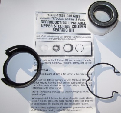

You can get a new lower "bearing" pretty cheaply, but there's also an upgraded one on the market.

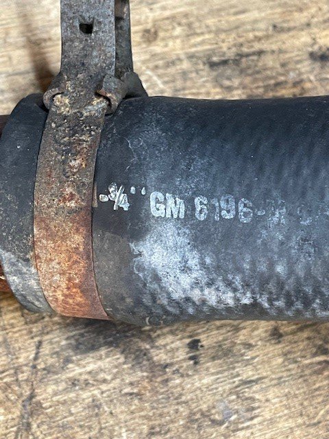

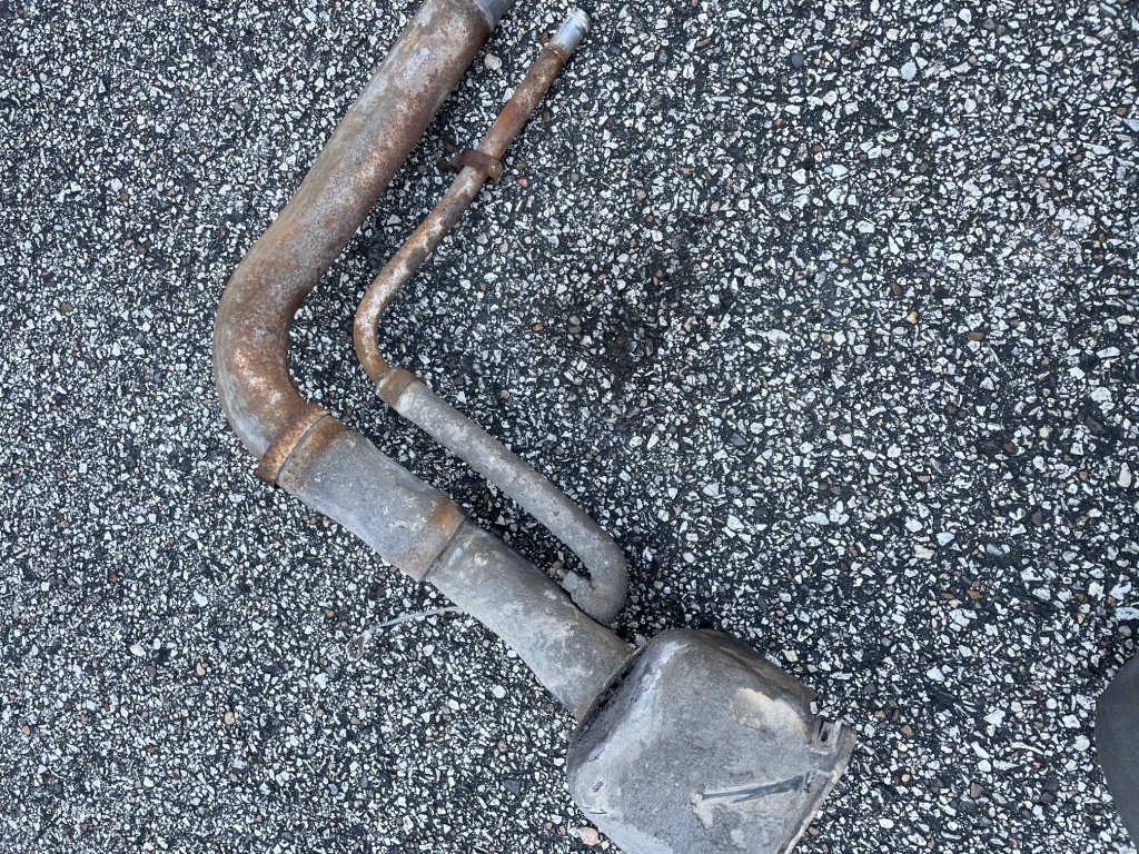

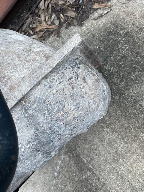

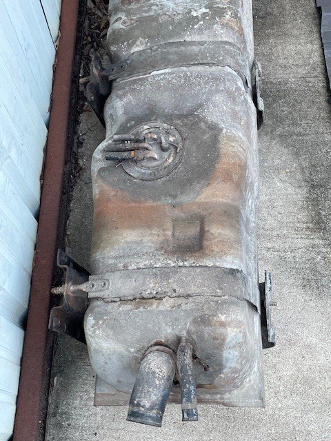

Pulled the pass side fuel tank. It's never been in use since I've owned the truck. The PO tried to patch it with glass. I've been running off of the driver's side tank for years. I bought a new tank, hoses electric pump and a pickup several years ago. I was going to upgrade to F.I. , but have decided against it for now. I was going to replace the driver's side tank with the new one. After looking at the mounting of both tanks. The pass. side looked easier to access. So here it is.
I've purchased a second pick up non F.I. and some more hoses. I like to buy things twice, sometimes three times. :oops:. I bought a new tank valve genuine GM from the zone. I will be replacing all the rubber with new. I would like to go AN fitting and hose but can't justify the price or how much a pain in the butt it would be to work it. The hoses on the filler are GM. I'm guessing they are original 40-year-old pieces. They look good after a bath in simple green, even the old clamps loosened up and could be reused. The tank and straps not so much.
