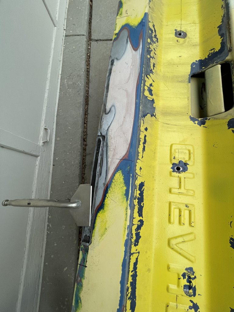

Cut out a small area of rust on the driver fender, also cut out a small area of rust on the tailgate. Much to my surprise, the tailgate had a patch of bondo on the middle bottom area of the tailgate. I got to looking at it a little closer; tailgate not very straight along the bottom so PO slopped some bondo to make it look straight. I purchased a new tailgate last fall so I’m considering using it rather than the oem tailgate that needs straightening, welding and bodywork.
What’s your opinion on LMC versus OEM tailgate from a quality standpoint?
I’ll have to drill four holes for the trim piece and transfer all the hardware so a little bit of work too.

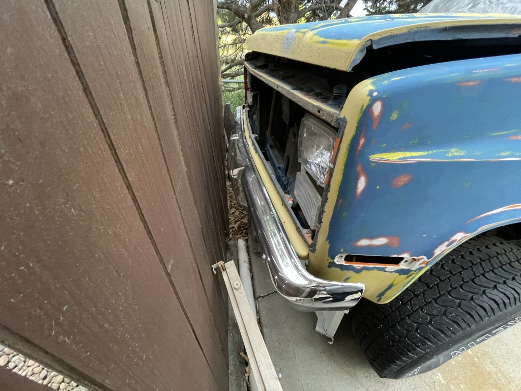

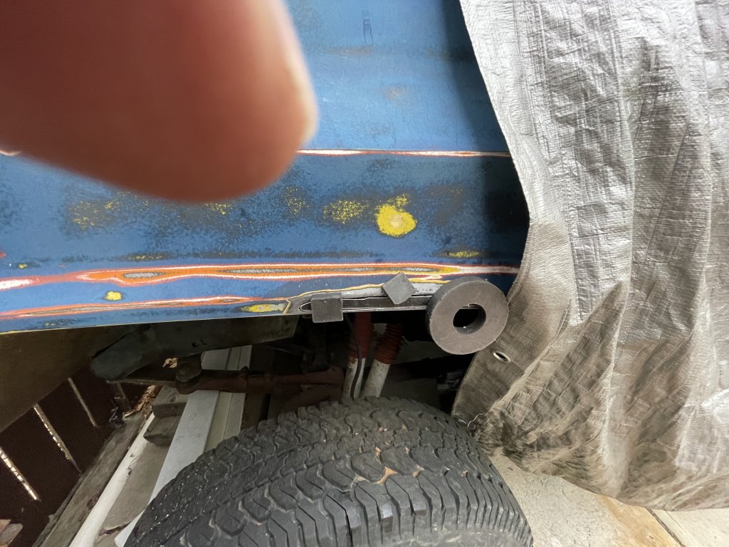

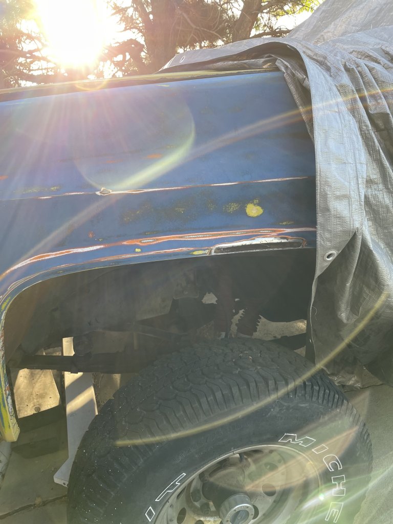

Fittted the new metal to the areas I cut out yesterday. Pulled the front grill and trim, and soaked front bumper bolts with penetrating oil. PO used straight screws with nylon lock nuts to secure grill, WTH. Cussing the whole time while removing the lower center bolt. Gonna weld the metal tomorrow if not windy; gonna pull the bumper in between welding cool down.

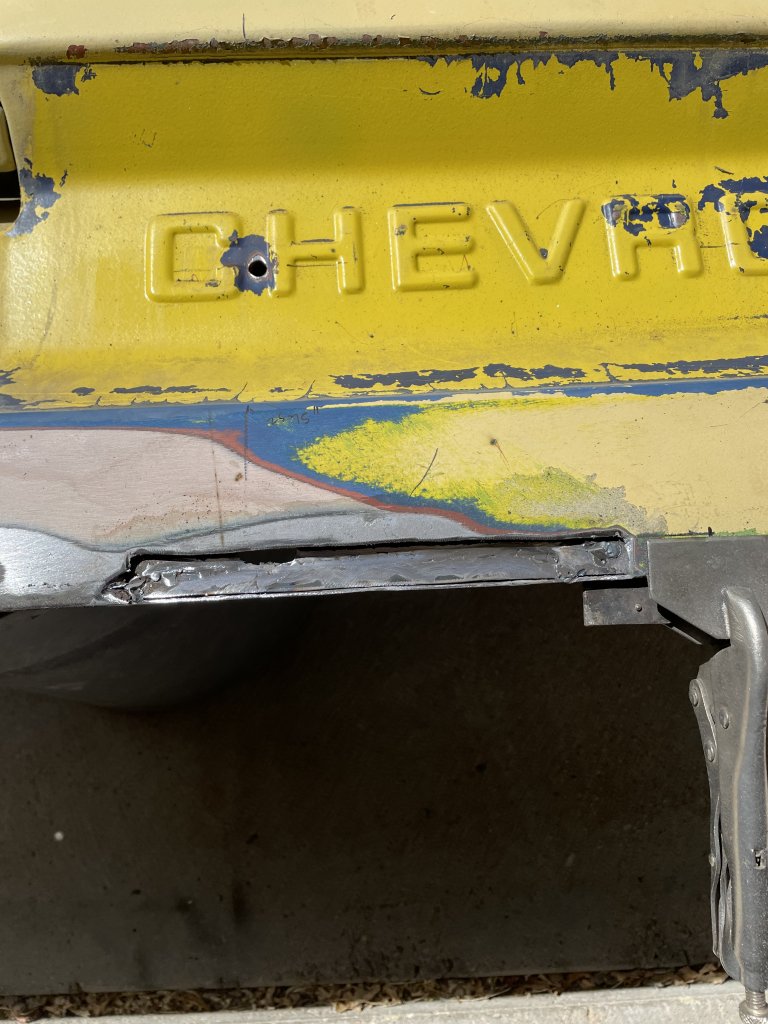

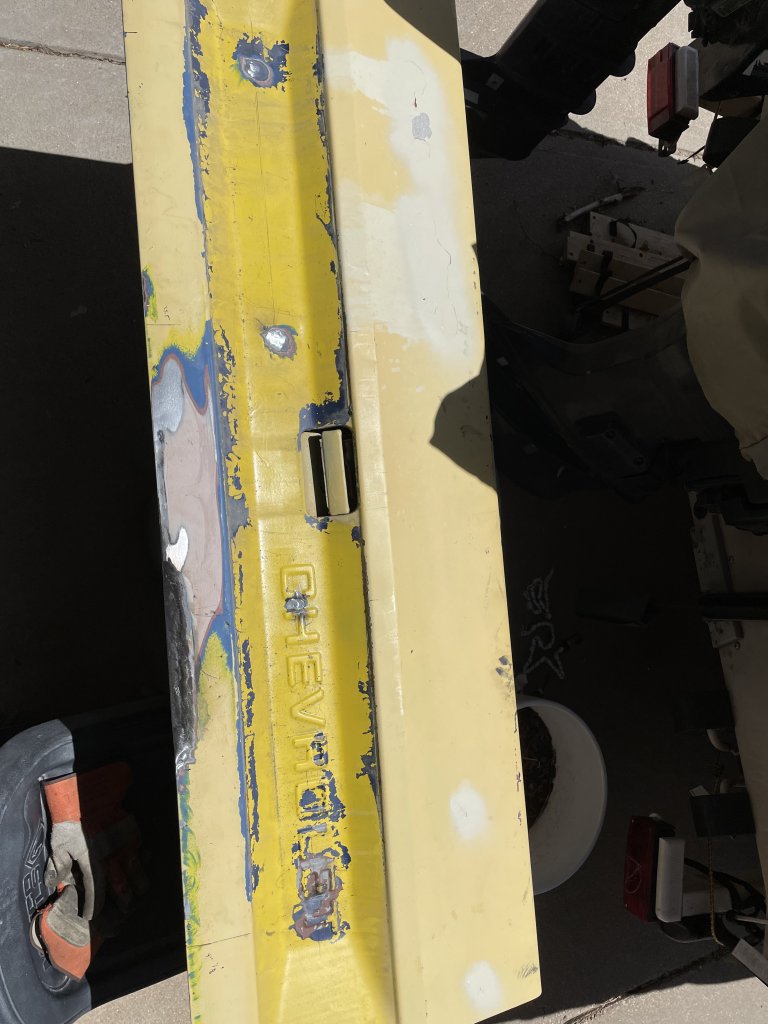

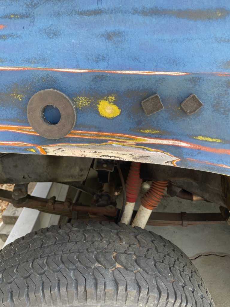

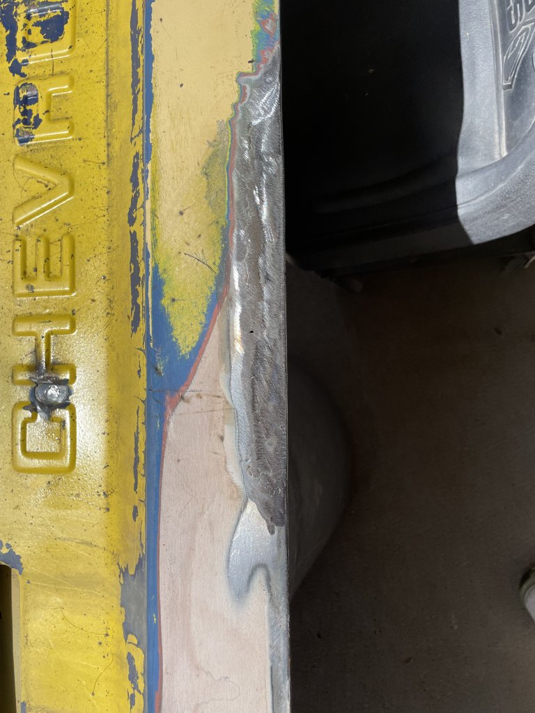

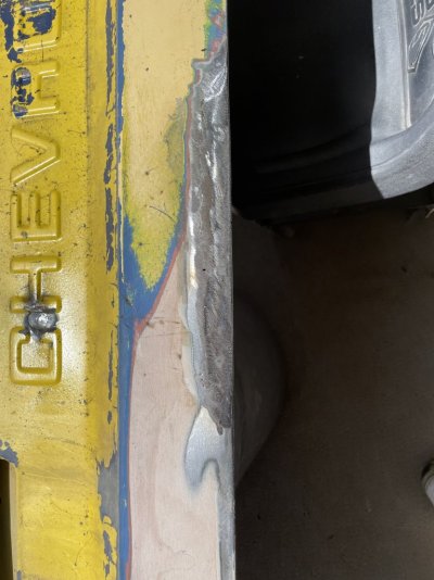

Weld and grind metal patches this morning. Time to take a break for some other fun stuff. Also welded the holes for the trim piece since I will use it on the other tailgate I bought last fall.

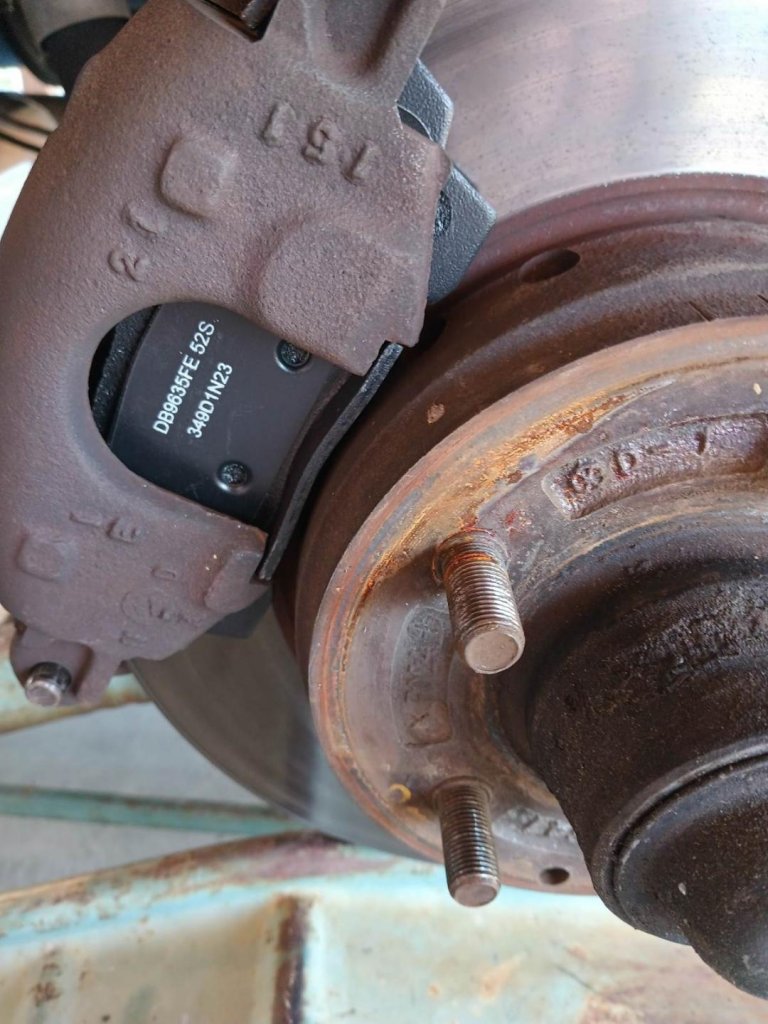

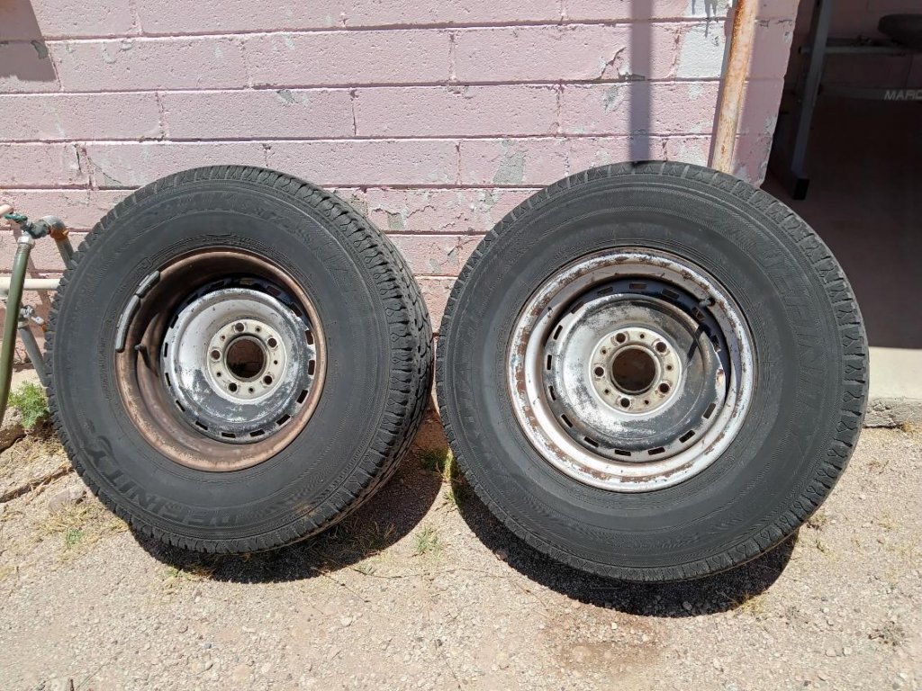

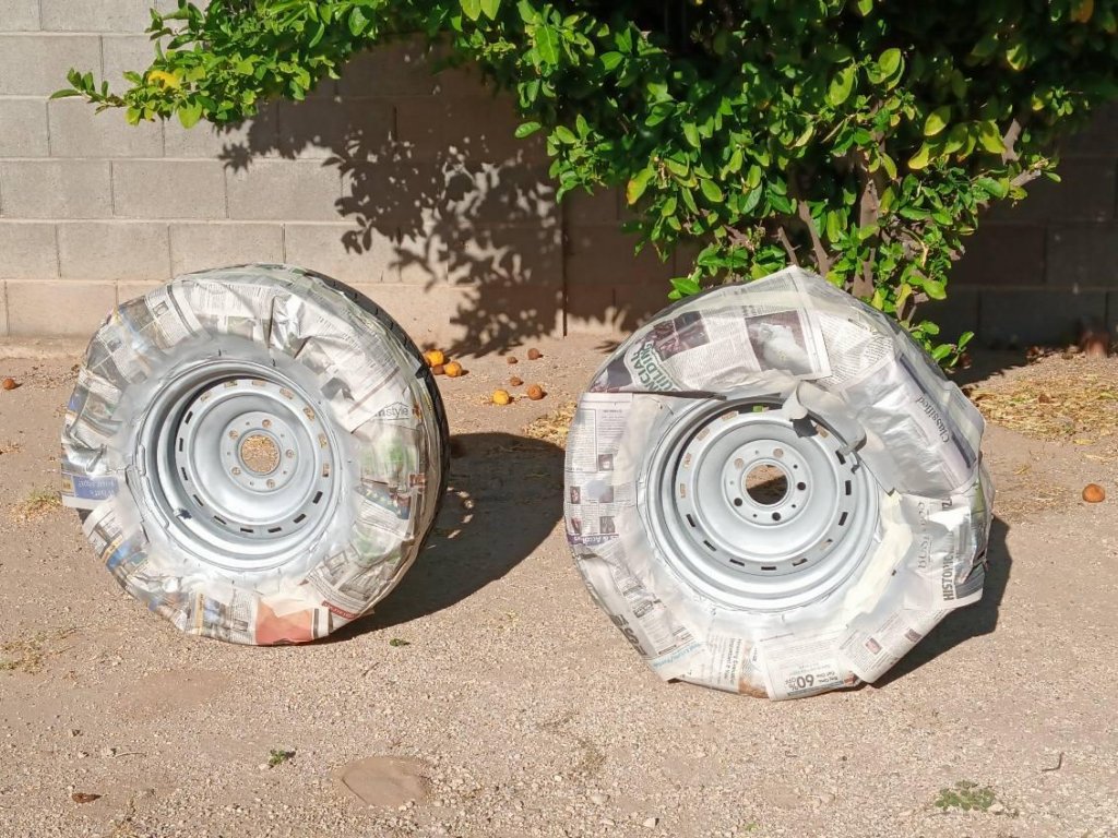

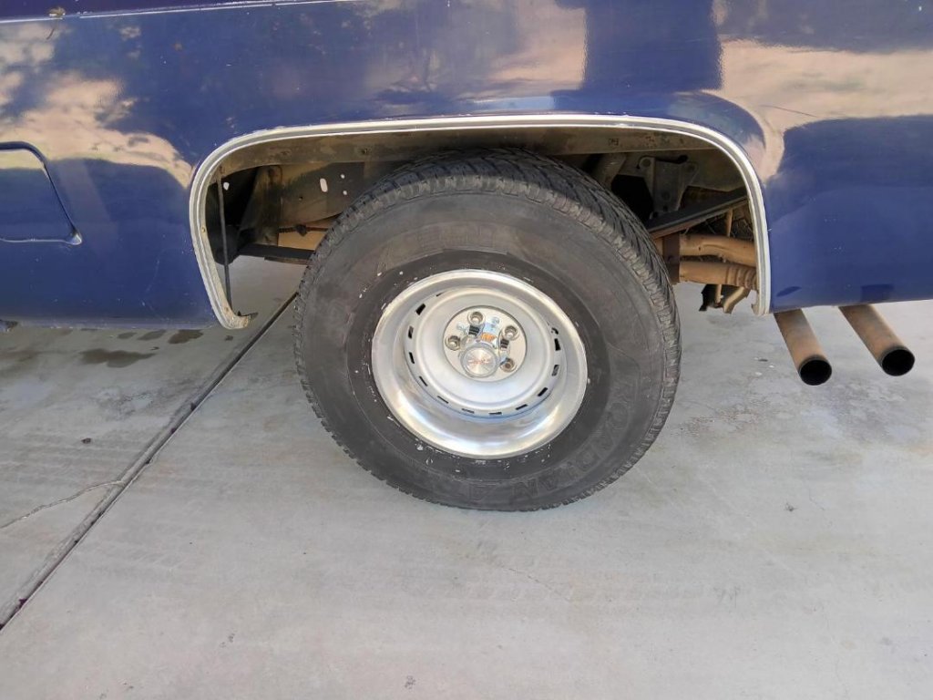

Brakes and rally resto's, two down two to go
