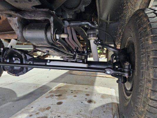

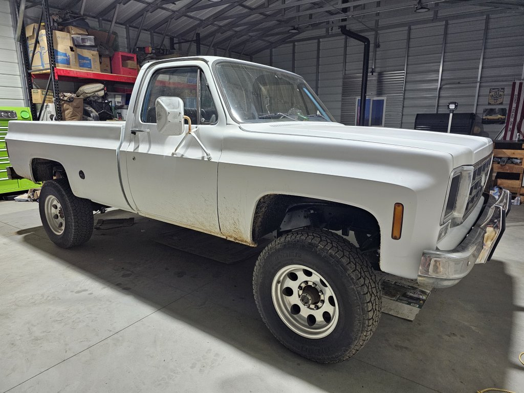

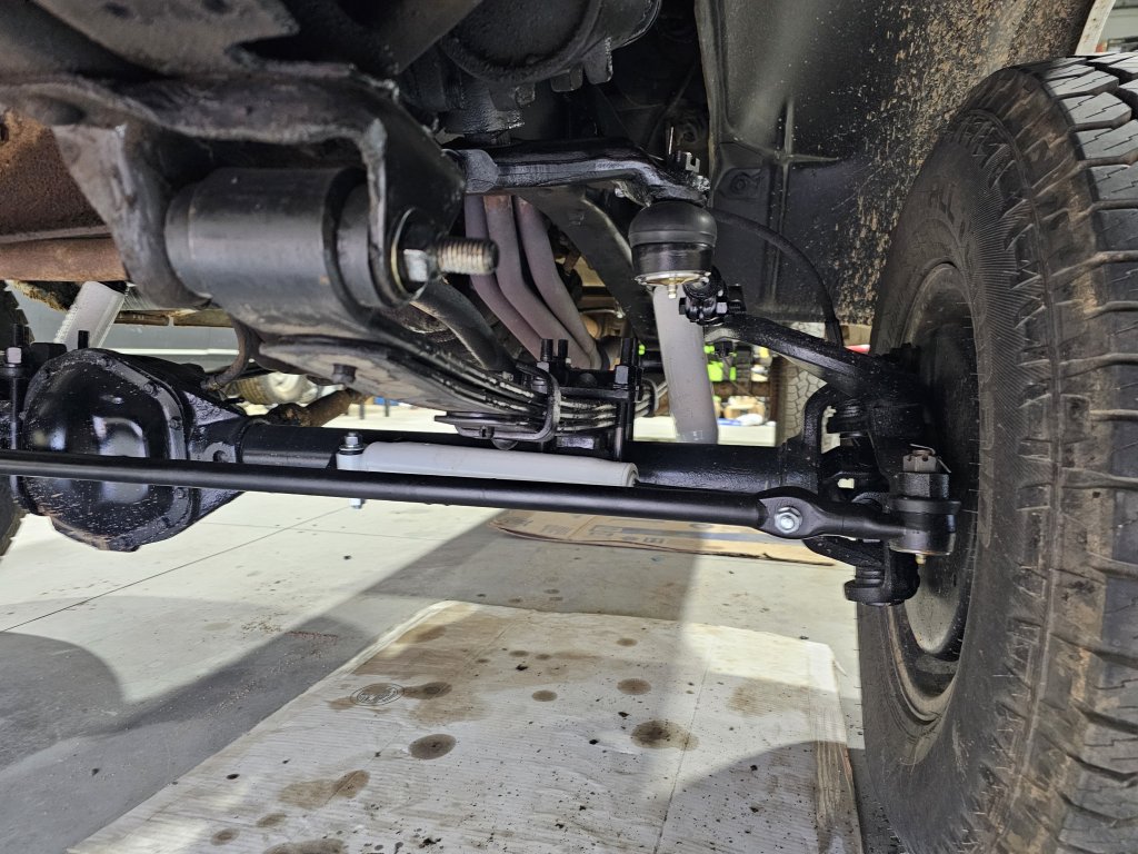

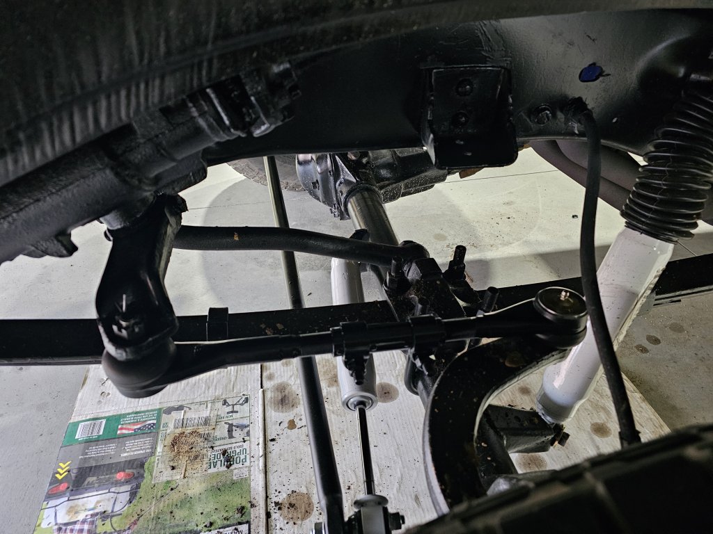

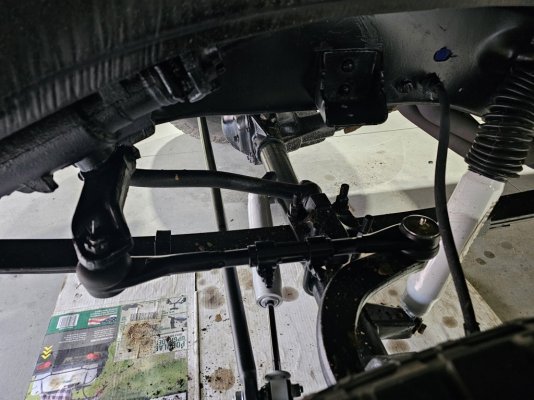

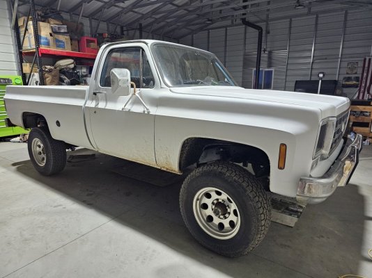

Installed a 4" Tuff Country ez ride spring lift with their SX8000 shocks. New tie rods,pitman,drag link and steering damper

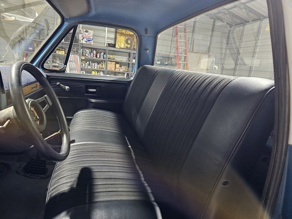

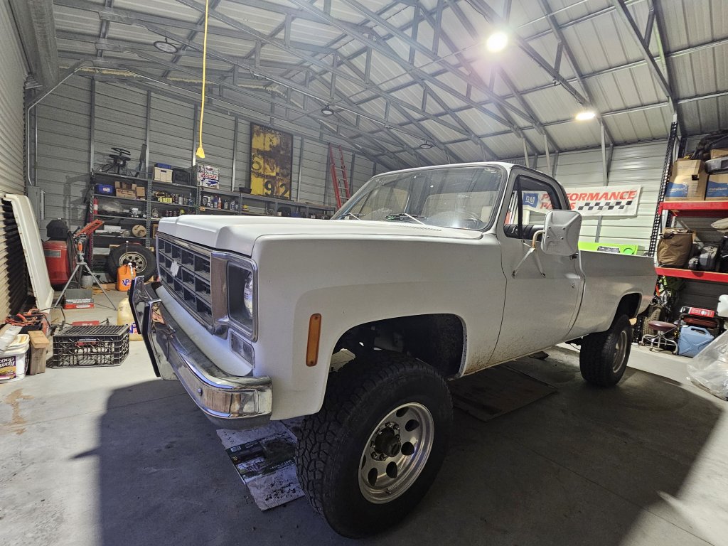

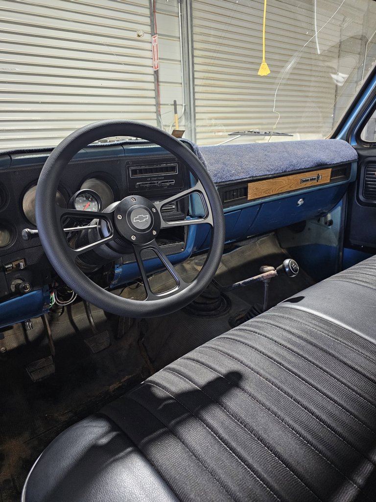

Test fitting the interior before sound deadening, carpet and dash/gauges. This is probably where I'm stalled at as far as interior until I address more pressing mechanical issues.....which are on deck
I highly recommend a sway bar disconnect kit. I have the exact same springs and shocks on mine. Before the sway bar disconnect kit, it was rough. Sway bar connected with the disconnect kit, back to feeling about like it did stock, then with the sway bar disconnected, rides great.
