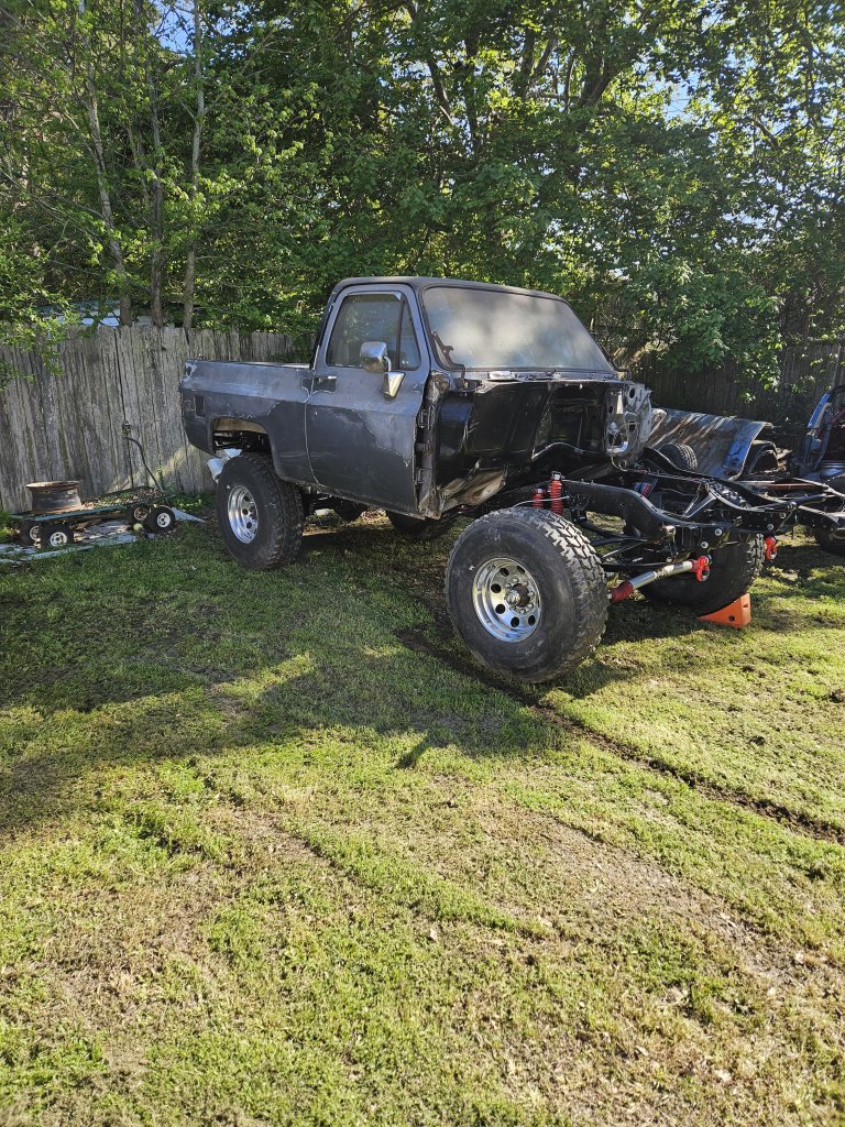

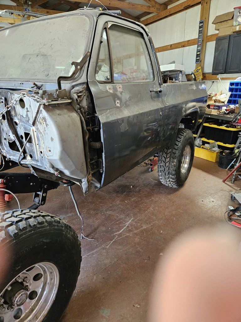

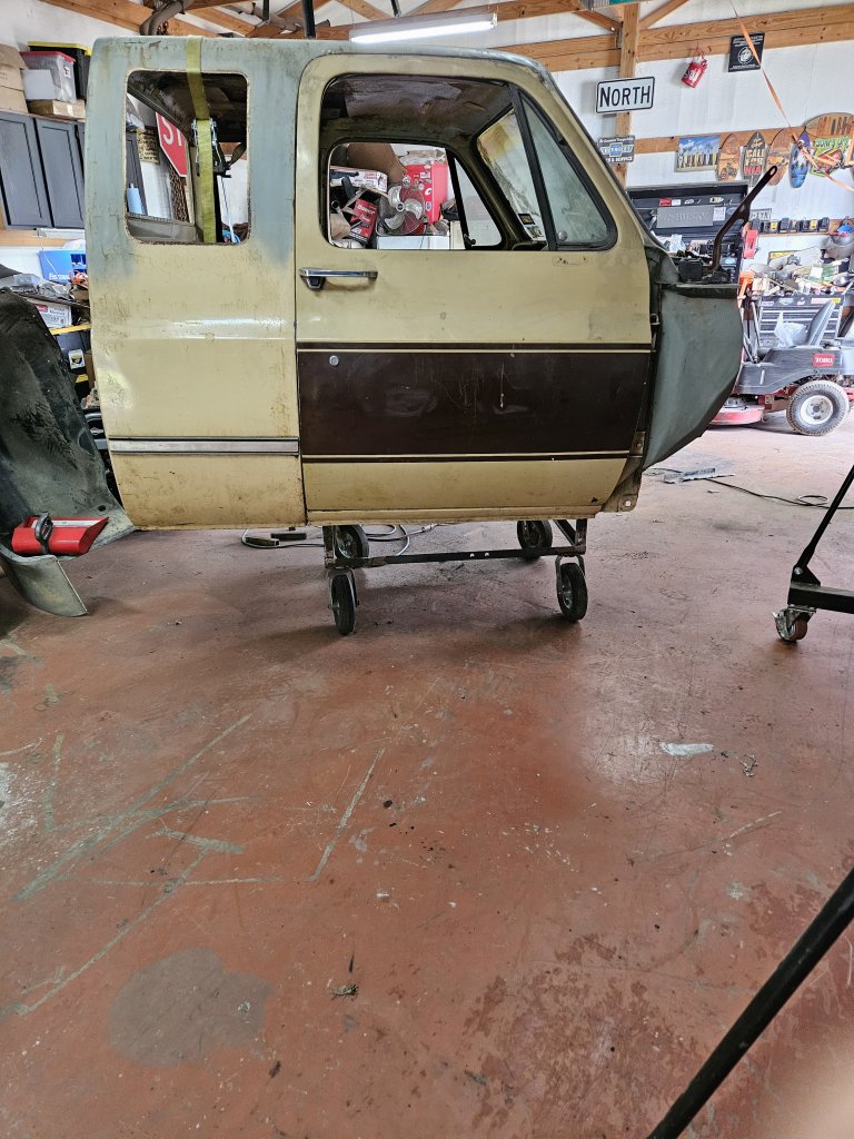

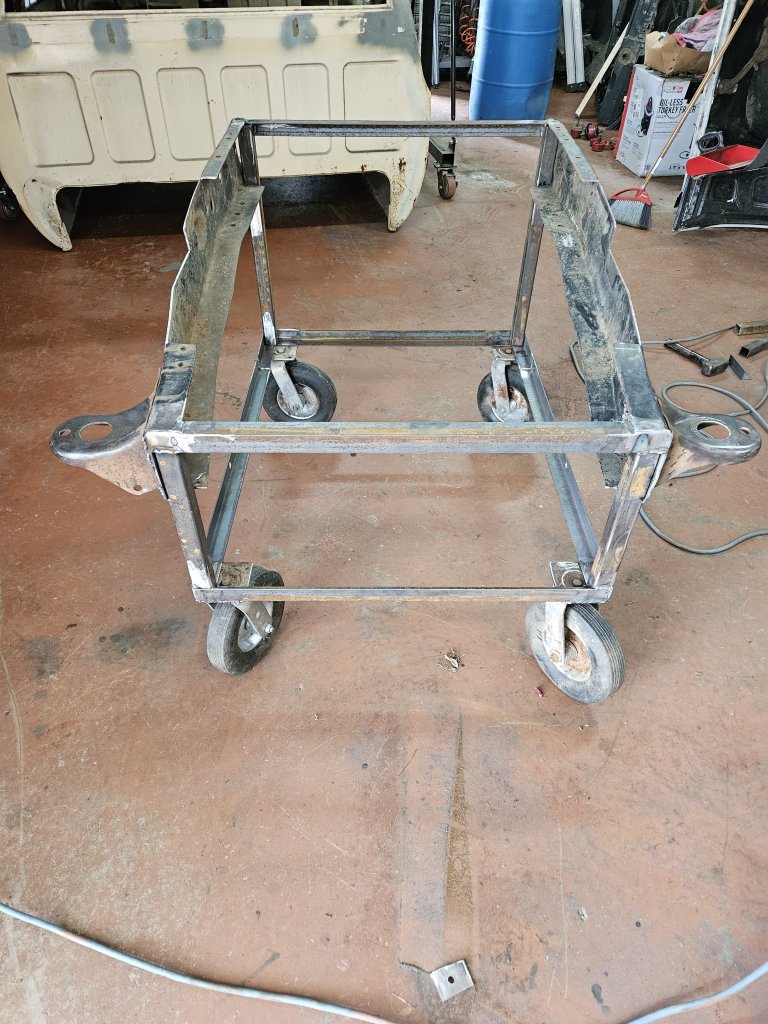

Got the Blazer body back on the frame, and put outside. Took the cab off the Extracab. Built a cab cart for the cab. Put the frame outside. Trying to make some room in the shop.

O man that blazer is cool but that ext cab is awesome

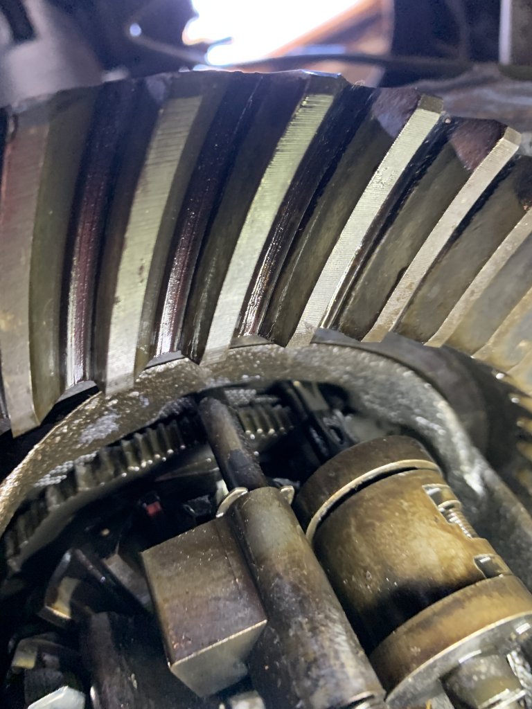

Spent the weekend getting the axle back under the truck, new rear brakes fitted, new brake lines and cables run. Decided to remove the diff cover and clean out the old fluid and get everything sorted before I move on to other items than need to be fixed.
I expected to find an open diff, but was surprised to find it had a G80 locker. This would have been a nice discovery until I looked closer and found the gears on the actuator were stripped and the gear plate that sits behind the spider gear is cracked in at least 5-6 places.
So today I guess I am looking for a replacement diff. Sucks but I guess I am lucky to find it before it exploded and completely destroyed the rear end.
