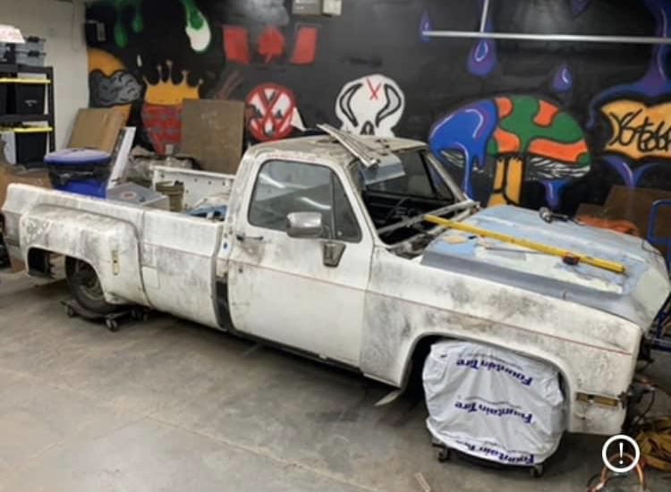

I did some cleaning & arranging in the shop today. I had a mountain of wheels & tires in the way the past couple weeks so I decided to carry my half-crippled self & install them on my next project. Recuperating from a heart attack 9 months ago & neck surgery 9 weeks ago...I didn't do too bad today. I also got the 46H JD home this morning. Now, I'm whooped!

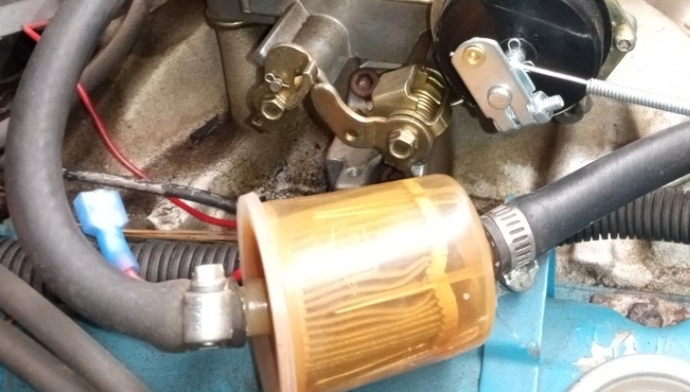

Installed Holley Bypass fuel pressure regulator
Replaced rocker arm cover breather with PCV valve vented to air breather
Replaced old exhaust manifold that kept blowing gaskets with new one that sealed up exhaust
Replaced manual choke with electronic
Installed phenolic gasket on carb
Engine is running at normal operating temp, better fuel mileage and more power. No more oil, gas and exhaust smell under the hood.
Happy truck!!!!!!!!!!!!!!!!

Replace your fuel filter. Check this out.
