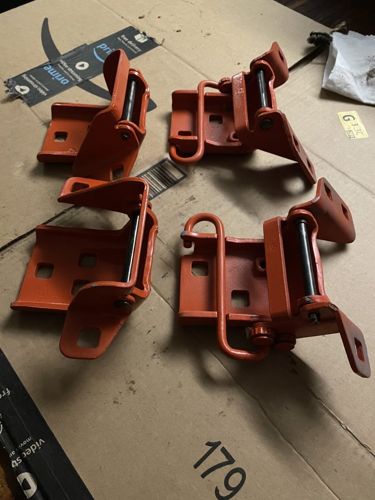

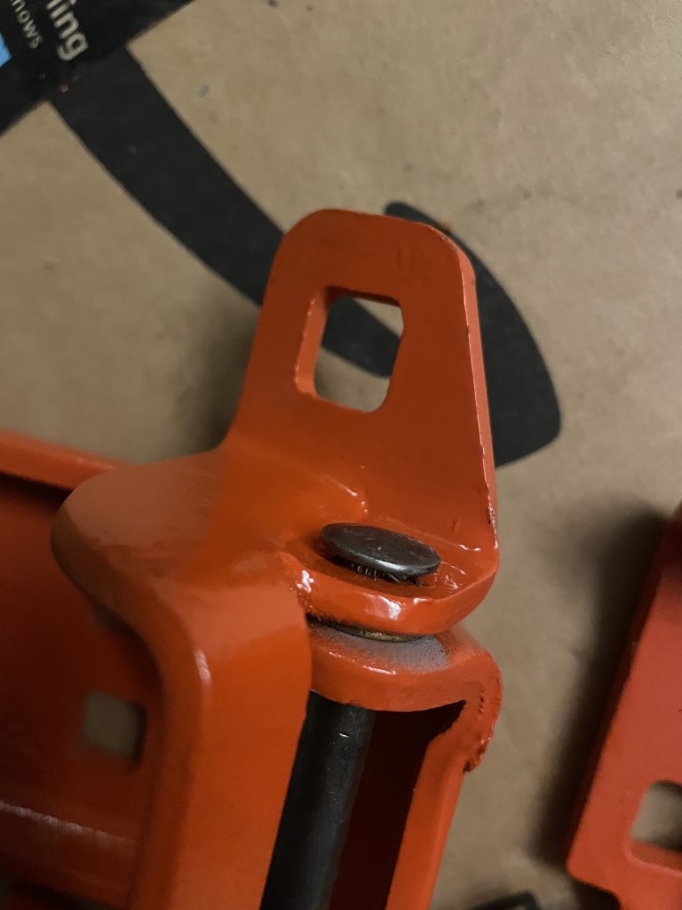

New greased bushing for the door hinges.
