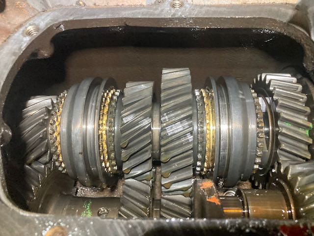

Bad leak from my saginaw transmission. So pulled side cover to get to shift fork seals. Both were gone. 2-3 different from 1-R. New o-rings installed and back together. Inside looks OK. used fluid extractor to get oil at bottom (no lower drain plug). Filled with Redline MTL.

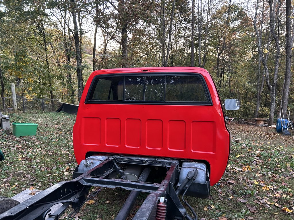

Finally got the back of the truck painted and cleared . Also the head of the bed . Almost ready to assemble the bed back on . Wife helped with the sliding rear window . Was much appreciated.

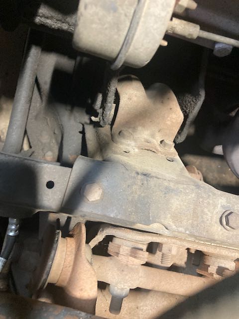

Tried to replace the motor mounts under my 6 cylinder today. Drivers side, first Nut underneath just spun with the bolt. As that was the first of 6 bolts, and this mount looked really bad, I think someone bailed on this repair some time ago. I bailed too. Will have to wait for the new motor. Glad I didn't have more torn apart before it told me it wasn't coming out. Two top bolts shown in the picture. The one out of sight, underneath was the problem.
Did you put in a replacement for the back window(sliding glass) or just refurbish the mechanism??

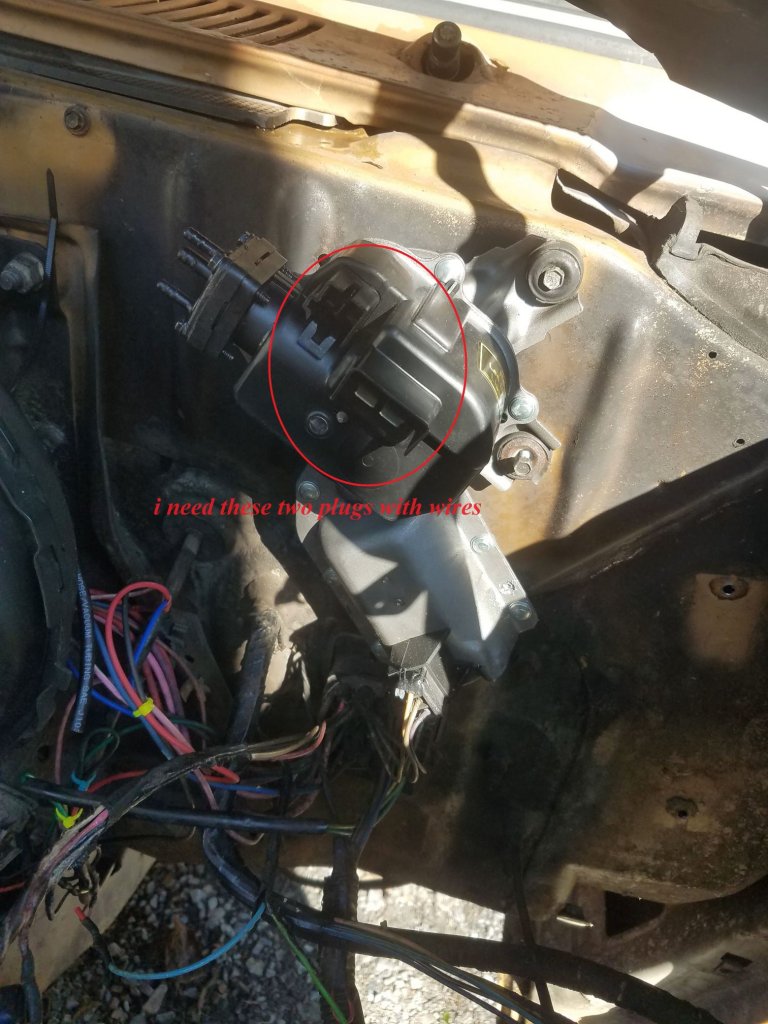

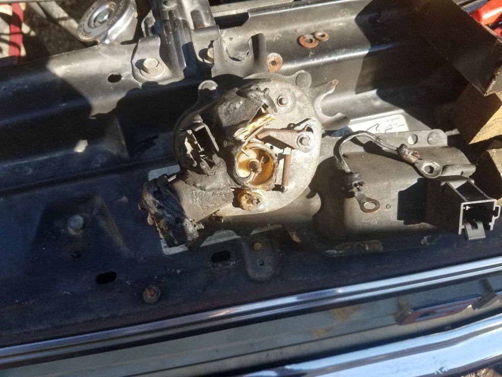

installed new wiper motor to replace the burned up one. now i need the wire connectors for top two plugs. anybody know where i can get those??
