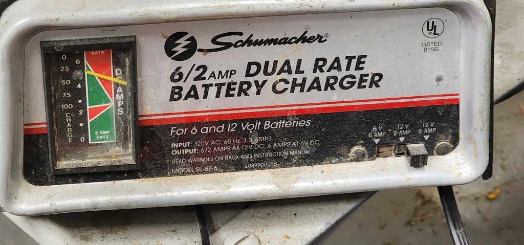

Done it years, wrote about on here before,my results have been amazing just never took before and after pics, but wish I had because no one would believe it. Your friends think your crazy when the see battery charger cables in 5 gallon buckets full of water. OMG these conversations bring up memories,don't remember what site I was on wrote about doing this to a cam out of my scrap pile,had to have something THAT DAY p.s. it's still in the truck a decade later. Anyway a reader,wrote does this work on aluminum? I was speechless someone else saved the day with this little nugget of joy. Do you have a bunch of rusty aluminum parts? Lol. Read your link, a lot more elaborate than how I do it and have had great results. I hang a couple pieces of whatever ferrous scrap I have into wash soda and water with a wire connected to a battery charger, hook my other piece the same way and hang it on the opposite side,and let her rip.

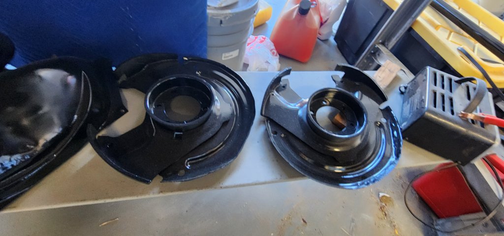

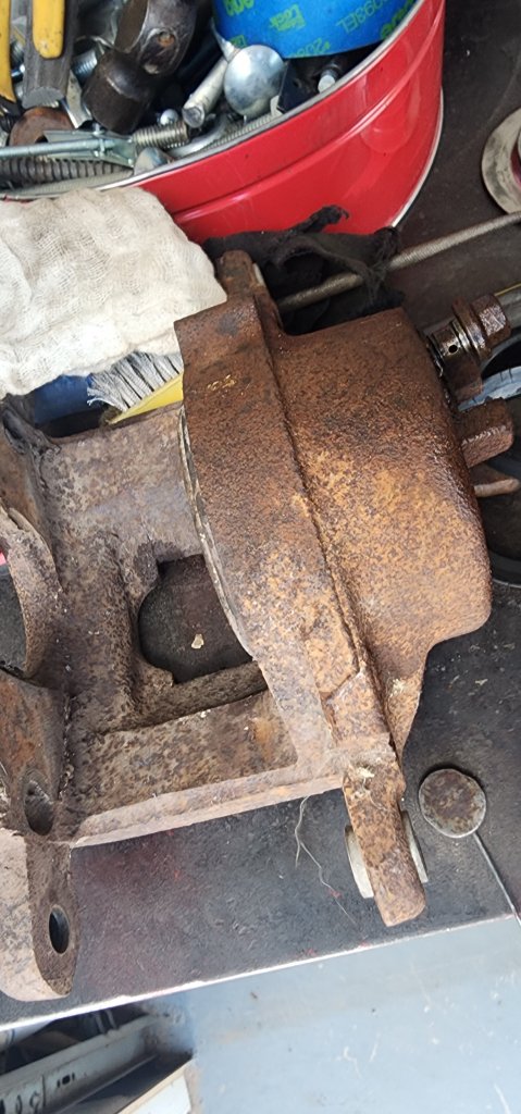

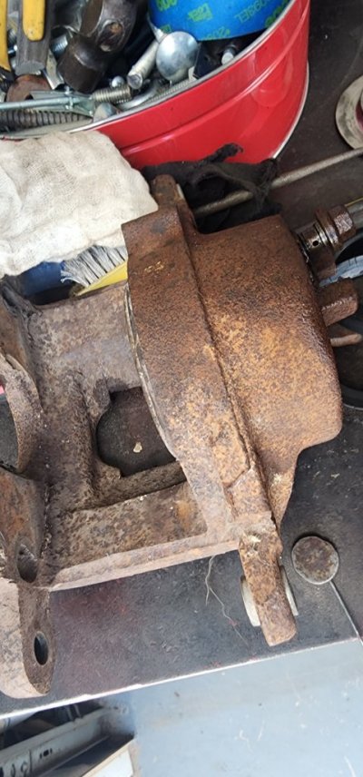

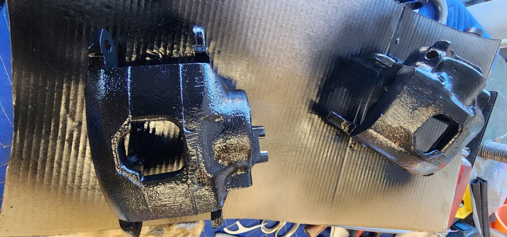

Headers / exhaust manifolds and maybe wheels that have surface rust on the face.
Hi Jody! I hope all is well.
As long as you have a large enough tank that will fit your parts that will work good.
Non toxic, non hazardous, just be quick to wash with fresh clean water and I spray it with vinager to stop the flash rust.
I clean the parts with laquer thinner before primer or paint.
This is a really good short write up on this site.
Be well and stay safe out there.
Best wishes to you and all of your loved ones always!

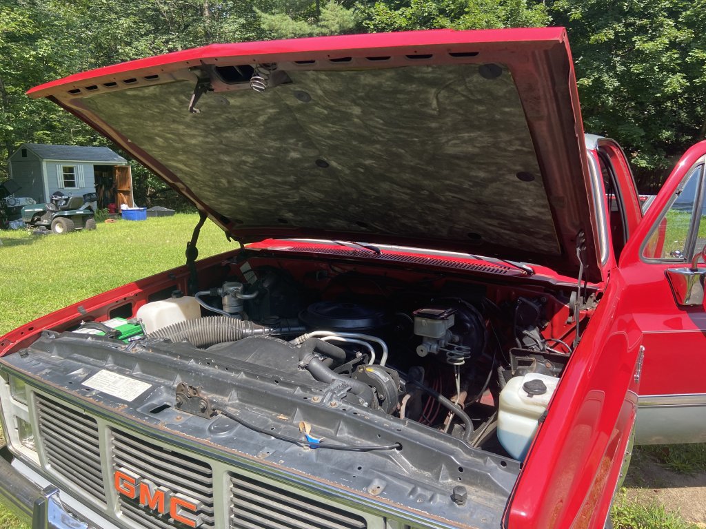

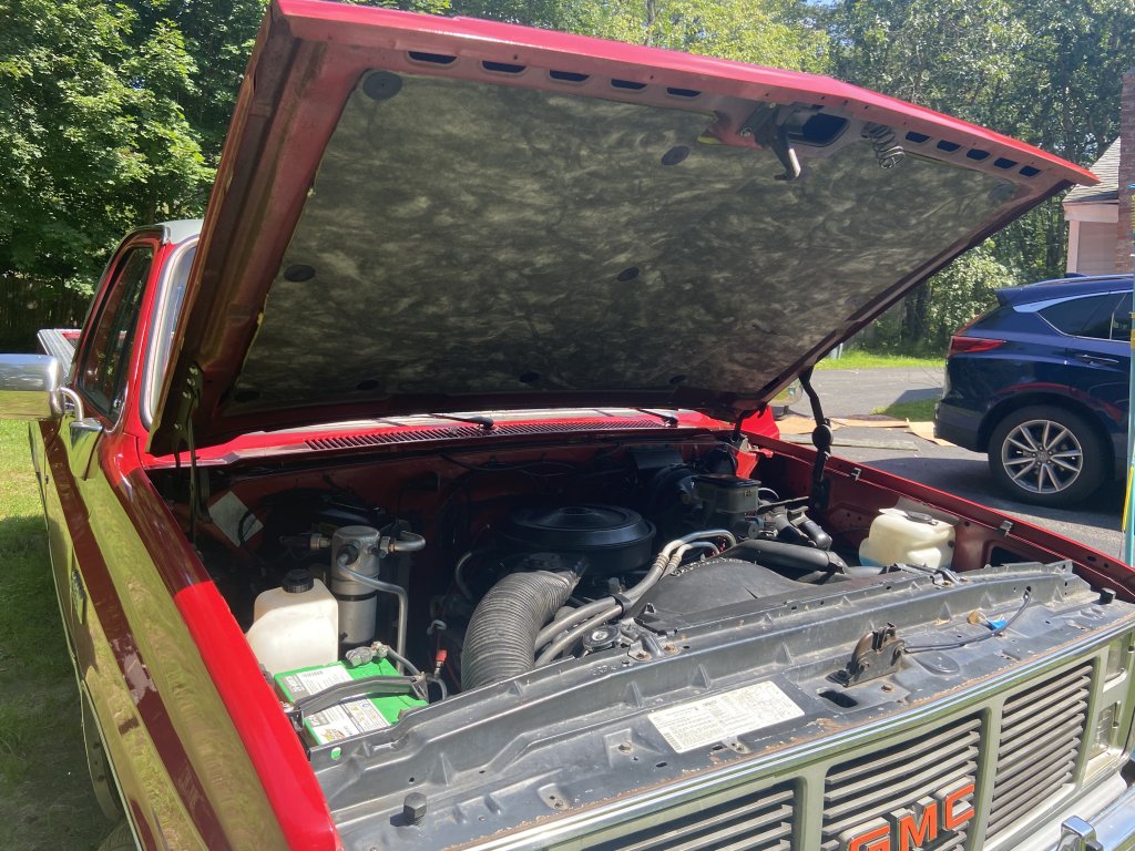

I installed some generic hood insulation from LMC today, it’s okay. Not perfect but pretty okay. It sure would have helped if they offered a template or if I had a spare hood. If anyone else is doing this I recommend at least 15 Christmas tree clips
I have one but wasn't sure if I'd use it or not. This looks GOOD. Really cleans it up. :pimp:
