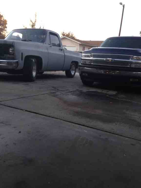

Just got some 15" rims with tires for my 78. I like it a lot
[ATTACH]15712.vB[/ATTACH]
