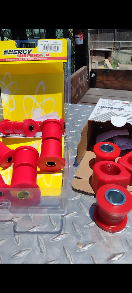

I’d argue that DW has contributing factors that involve any and all front end components as well as caster. Especially spring bushings.
Bad shocks or stabilizer won’t cause DW and imo there is a small chance they could partially mask the real causes but who’d want to do that.

Yup they are 7.5r16 and who knows how old new bushings came in today tires just have to wait for a bit pretty limited on size I can run on the duals+being a cab and chassis truck I don't want to use spacers so 235/85r16 is what I'm looking for
