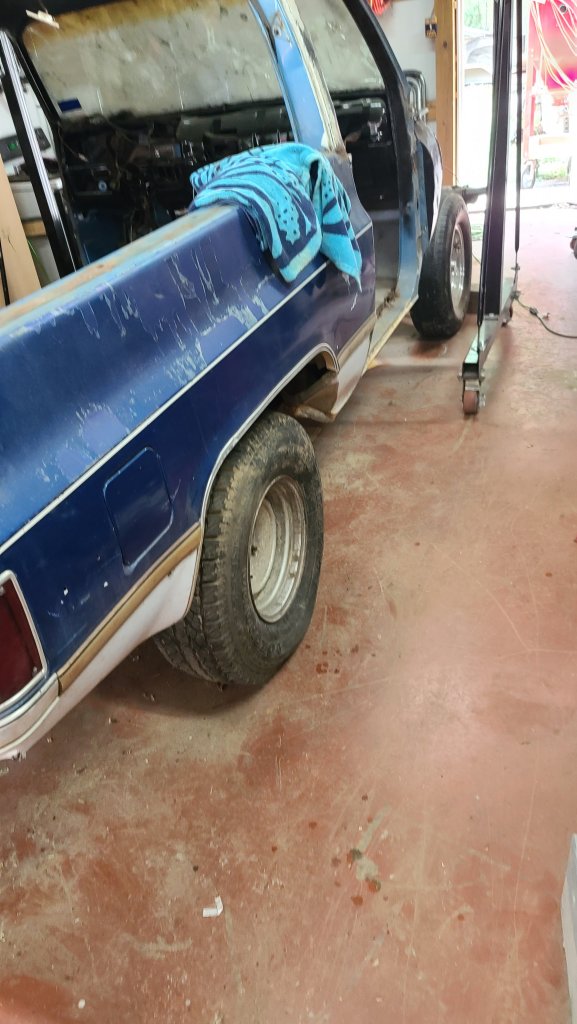

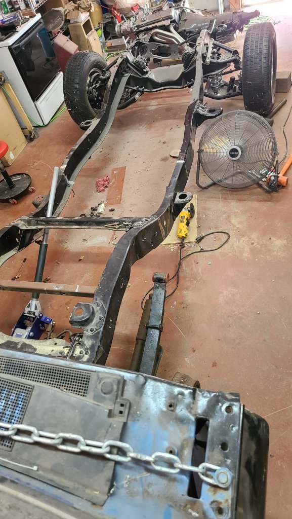

Worked all night, got home at 0730 and got after it. Pulled the body off the frame to have easy access to the rear end, pulled the motor and tranny as one. Got a 10 bolt in the shop, half a$$ed mocked it up welded a couple pieces of angle iron to the axle and frame. put the body back on the frame, and ran out of "Want Too" plus it was getting really hot....

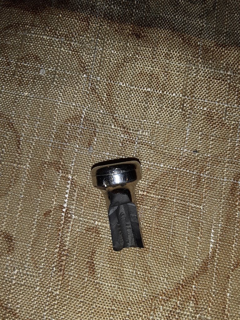

More quick and easy- kind of - projects.
1) Adjusted the drag link to move the steering wheel a bit to the right. Easy - turn the drag link the opposite way you want the wheel to move. (4wd, anyhoo )
2) Adjusted the shift indicator- since my shift bowl ( the plastic lower portion) is a broke pos, that required some black Gorilla tape that maybe will hold.:Big Laugh:
3) Sadly, the most difficult thing- one of my chrome doorlock knobs broke a while back. Tonight I bought a pair of the Help ones - 10 bux !
I had to cut the bottom portion off and then thread it with a Chinesium SAE tap set made by Pittsburgh. Had to wrap duct tape around the knob and hold it with channel locks. Had the tape wrapped around the tap and it got all twisted up, so killed some time getting that off.
It ultimately worked, at least for now.
Major projects, I know.
Busted knob below.

I have that cheap a$$ Pittsburg tap set, the pos. Not great, but I guess ya get what you pay for, haha.
It's done the job for me a few times, but it died a horible death the last time I used it.
