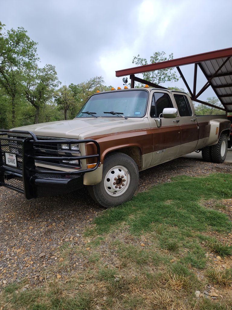

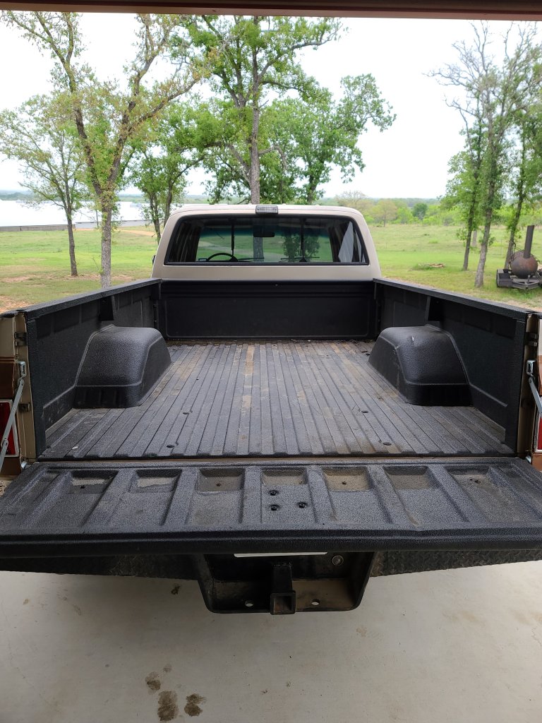

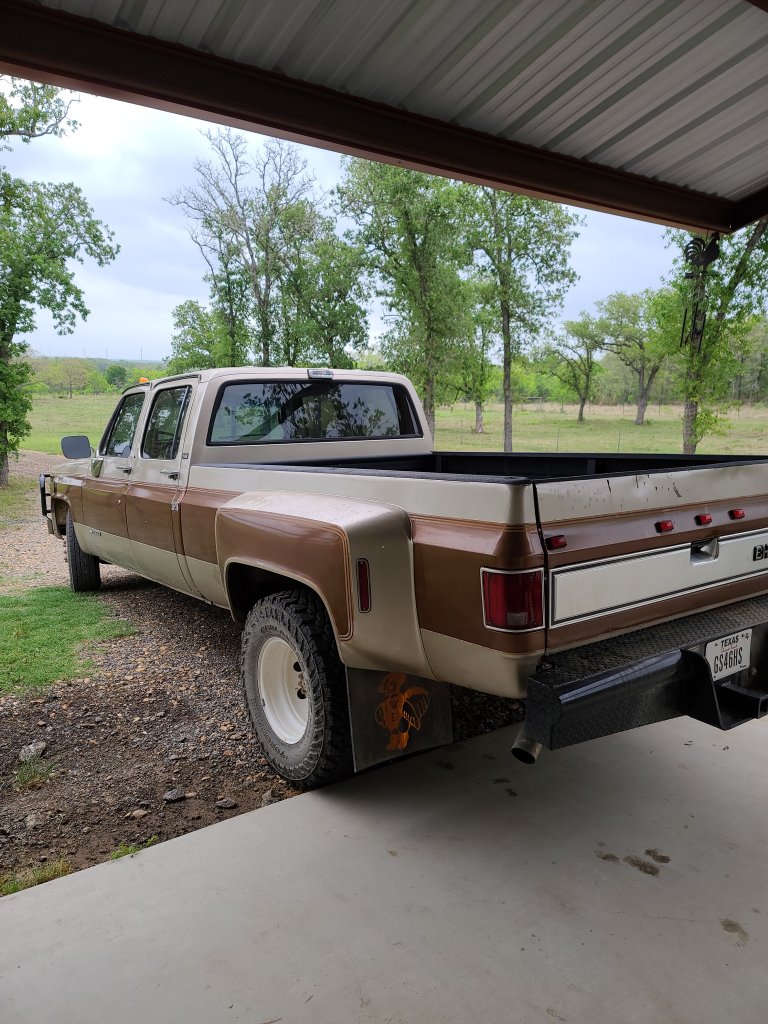

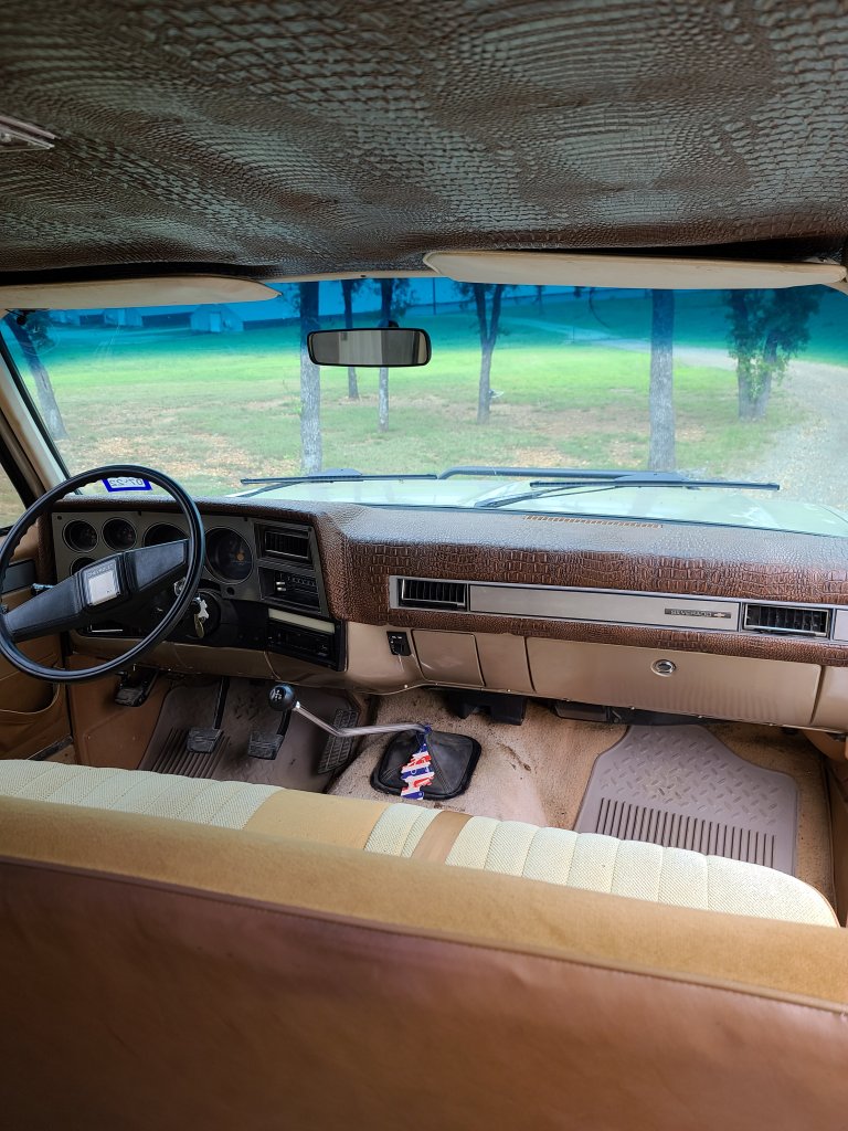

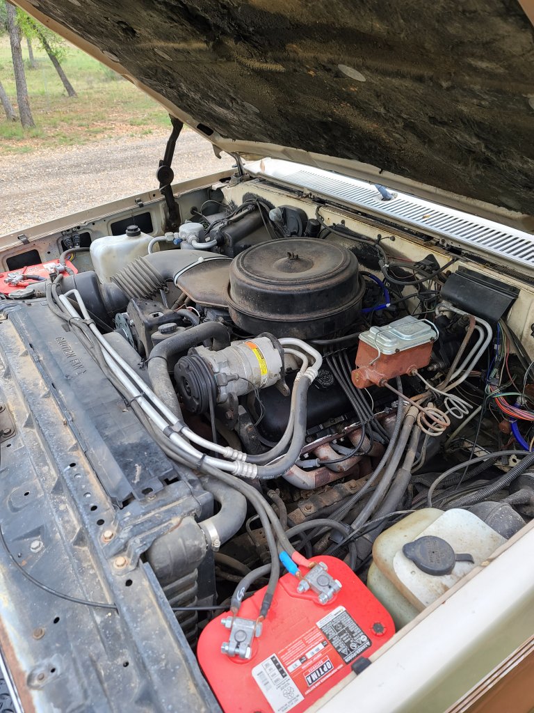

Got busy driving this guy around and forgot to show some of my latest photos.
Complete front end overhaul, upper/lower control arms, shocks, coils, tie rods etc.
Front and rear replacement bumpers.
It's been fun to drive! I've put maybe 5,000 miles on this guy!

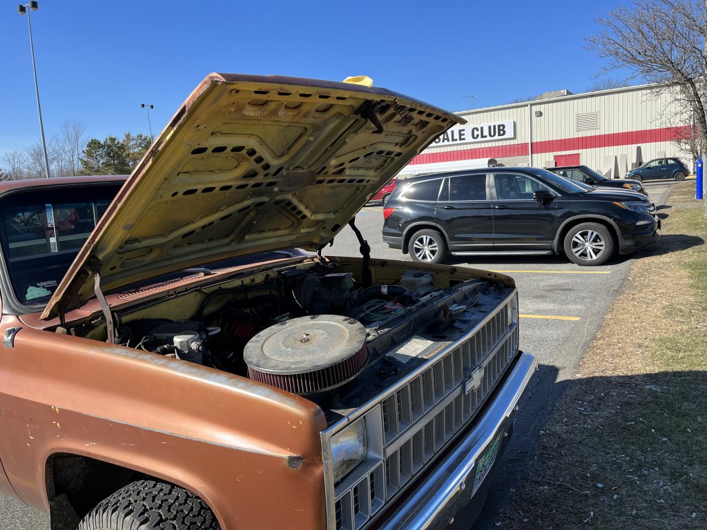

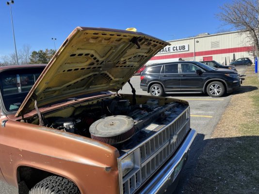

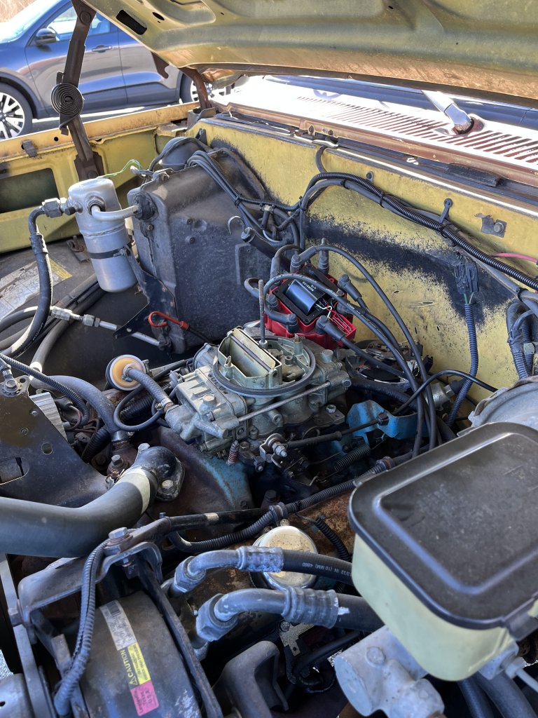

Had to do an emergency parking lot break down repair to get myself out of a tow. I got the 82 going for the season yesterday. Drive it to work and started running a few errands after work today. Just bought $180 worth of groceries, most frozen. Got in the truck, fired it up and after about 3 seconds, it shut off like I shut the key off. I immediately knew the ignition module but was in denial. Checked for battery and ground connections at coil. Even walked to the small engine repair shop across the street and bummed some wire from them to see if I could hit wire it but no luck.
Had to call my wife and have her load the 4 kids up and come get me. I had called the local Napa and bought a module and coil over the phone and had them put it at the front desk waiting for me.
My wife got there and I had to do the ride of shame out of the parking lot in the minivan . Came back with the parts and 10 minutes later it was running like new again.
I’m going to keep a module in my 76 and the 82 from now on. This is the second coil in a year on this truck. Friggin garbage.

What distributor you have?

MSD drop in hei. That module lasted about 8 years. I put a Napa one in last summer and now another. Probably china crap.
Ben
Good to know the msd lasted a good while. Guess I'll order some msd replacements.
