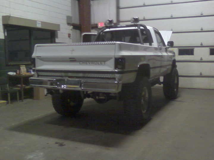

Hellllo really need some help with determining what frame will work for my truck. Bent the frame bad on my truck so I gotta find a new one, the problem is that i am not sure which frame is the exact same.
The trucks a 87 custom deluxe v20 with a 350TBI. Ive done a lot of research but can't seem to get a good answer, I saw that 81-87 are the same and then I saw somewhere else that 81-86 are the same and 87 is all alone. If anyone has some info, please share it!! THANKS

'87 is the same they just changed the model designation at that point.

from what I've seen and read any 73-87 frame works as long as it matches, like long bed or short and then 2wd or 4x4. It's just you have to have the body mounts match the frame, then I have heard others say that you can't use the 73-8 frame on a 81-87 due to front core support mounts on the frame wrong or something or vice versa, so IMO.
find a 4x4 short or long bed(looks short bed in pics) from an 81-87.
3/4 ton or half or whatever I'd think would be the same not sure tho.

Really any 4x4 long bed frame could be used, but there are small differences that would need to be dealt with. It's best to find an '81-'87 4x4 1/2 or 3/4 ton frame.
