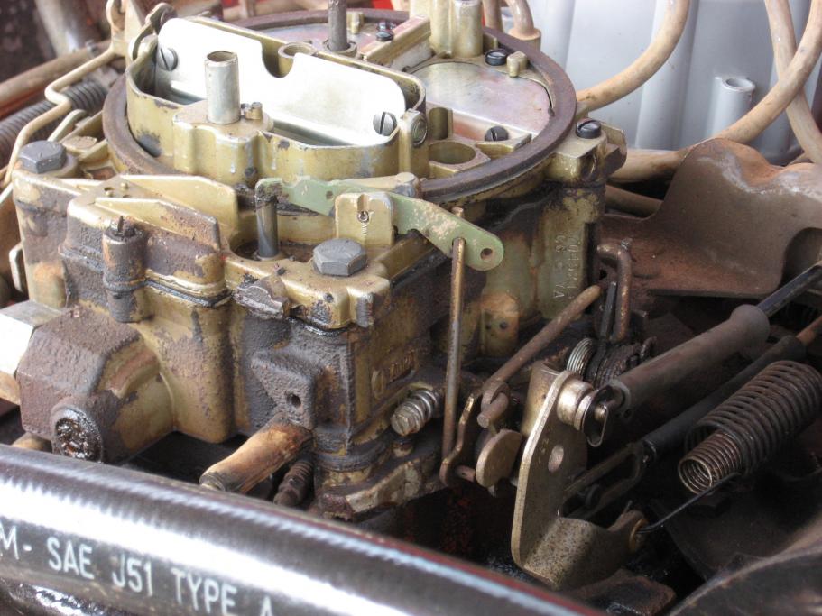

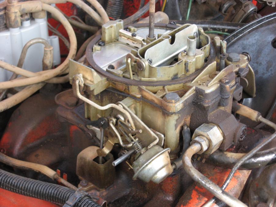

Pics of my Carb !!
I know it needs to be cleaned and probably rebuilt but here it is ! Hope the pic comes through !! Any idea's, Can't afford an Edelbrock just yet !! Oh yeah, I posted some other pics in the albums section.

With the truck idling does the linkage I circled hold the Secondary flaps closed?

Yes, the secondaries are held shut. I actually unpluged the vaccum line and drove the truck. It seemed to do better, I put the footfeed to the floor and the truck took off like never before, but the next time I tried it on same drive it started doing the same thing again. Frustration setting in !!!! Must stay calm !!
