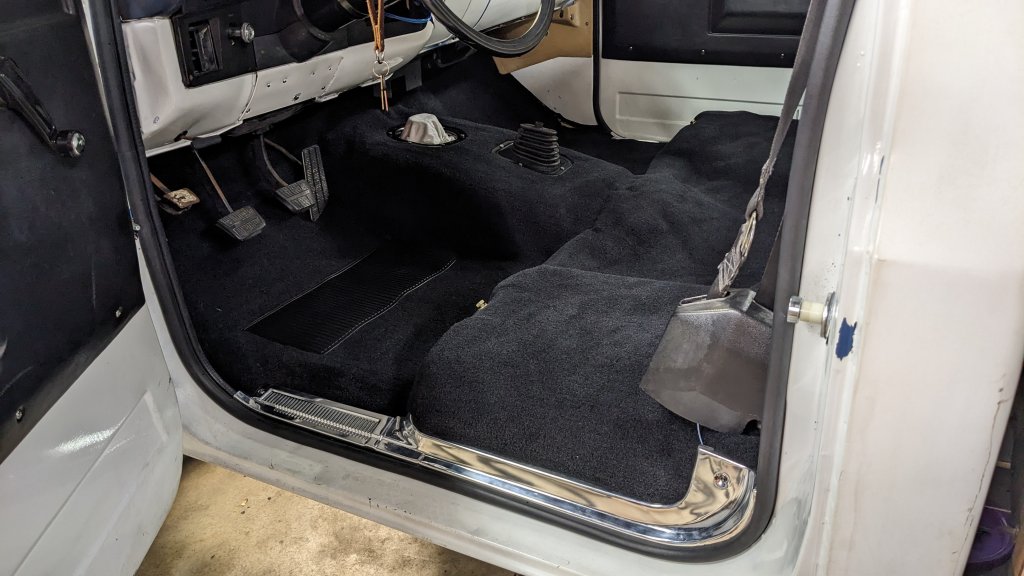

Just an update. The carpet is in. Fitment after the trimming...pretty good. For under $220 shipped to my door from rock auto. Not bad

So does the carpet come without holes for the shifters? Or, does is specify manual or auto trans? And is that ACC brand? Seems like a good price for $220. I think it looks pretty good, even better when the seat is back in. That poor gas pedal went thru hell in the process! lol

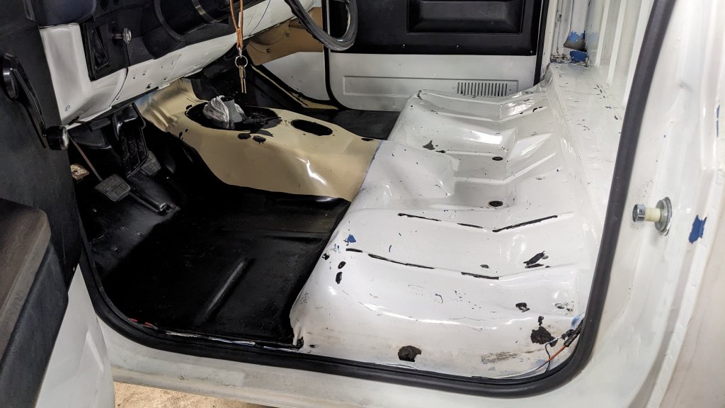

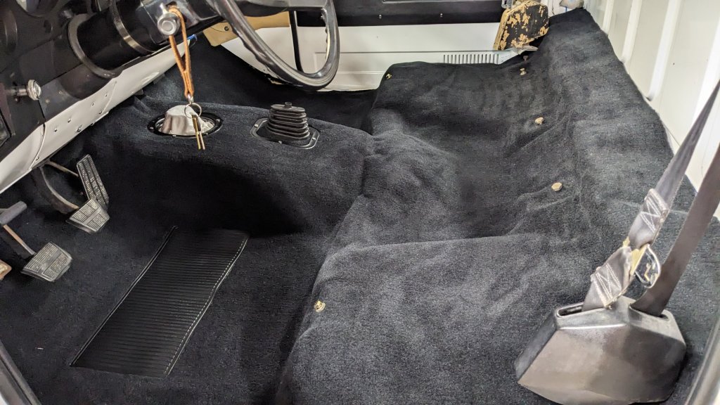

It's the ACC brand. I had a 5% discount code. My cab is a C30. The carpet i went with was for a K30. It comes one way. Supposed to fit a manual or auto trans. There were no holes in it. I had to cut out the trans and 4x4 shifter holes. I also had to trim around firewall. I cut 3-4 inches from both left and right sides. Had to trim around seat curve near rockers. And finally i had to trim it sort of straight to the rear of the cab. It fits the foot and tunnel area pretty good. The seat area ehh. You dont notice it with the seats in.
