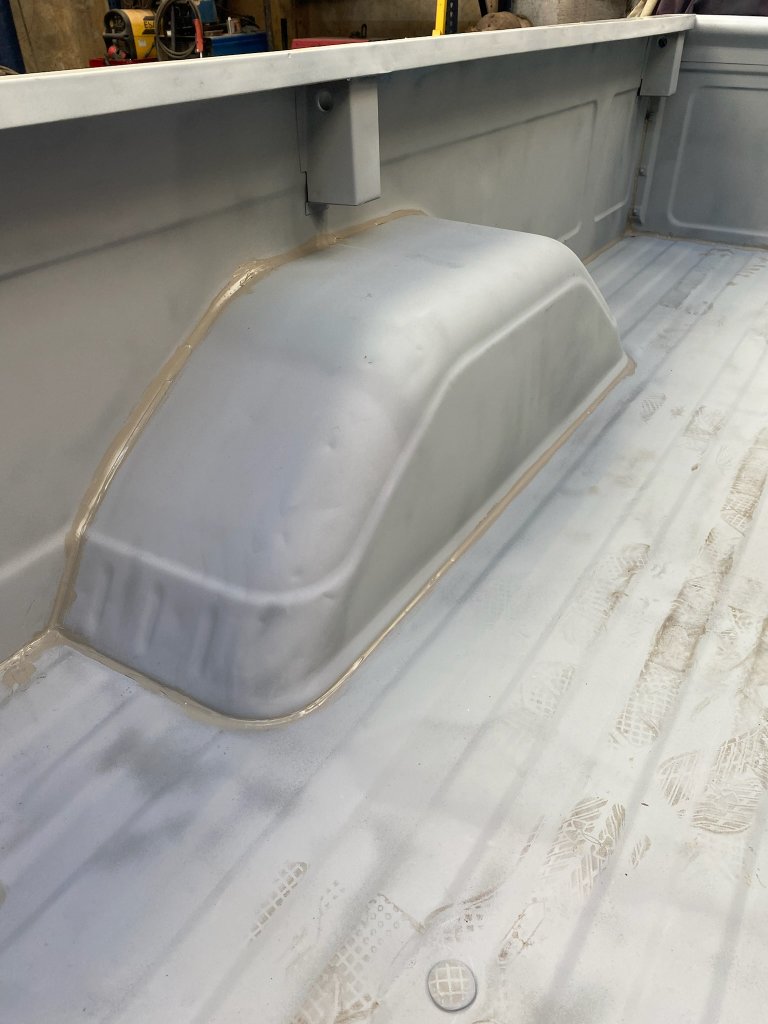

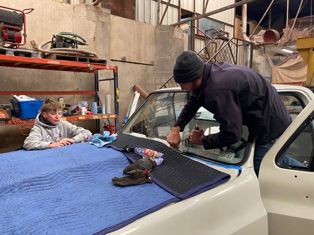

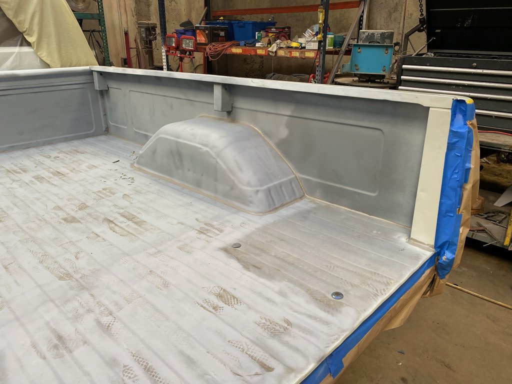

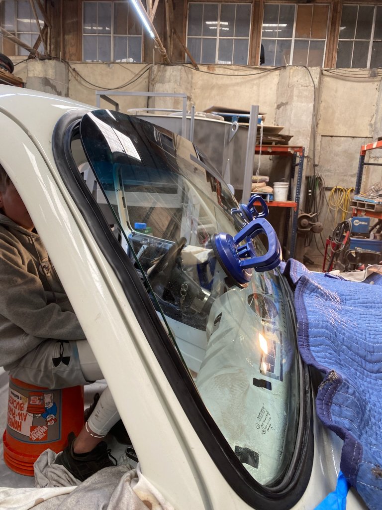

Well, we think we may have had a leak cowl to firewall in front of passengers seat behind glove box. That was before sandblasting and all the paint work we did. He used a very liberal amount of flex seal in cowl area. Fast forward 8 month later and he just washed it for the first time since paint and we found a small leak on passengers side side wall so we think that one is windshield but we did not have time to track I it down (its on the punch list. We plan on doing a leak test and check the cowl drains (never did that before) first, then move on to the windshield. Has brand new Precision self locking seal, so if it is still leaking on passengers side we will pull seal back and seal under the seal between window frame and seal.
Any ideas about what product to use there is appreciated. We used BASF NP 1 on the cab floor and bed seal lines and it worked great. All help appreciated
