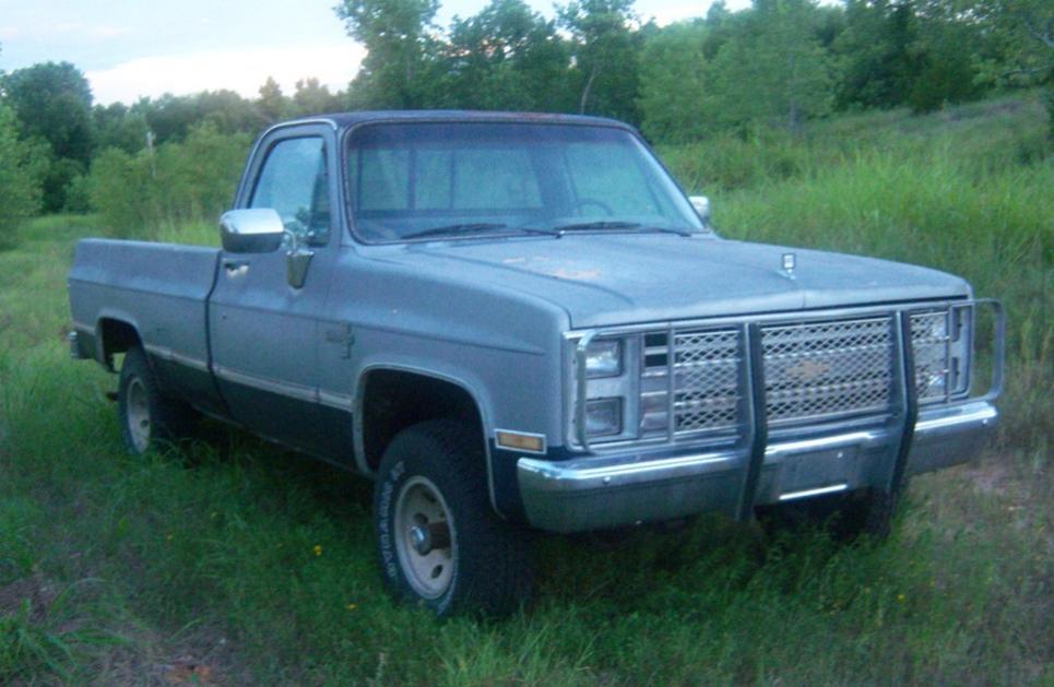

Almost sounding like you want my 85K10. Its already gotta gooseneck installed in it. Half ton though. And it was orignally a 6.2. Which wouldn't matter much since you are going Vortec and 4L80-E and changing the wiring anyway. My intent was to put the 14b FF and 3/4 springs in it, and find a Dana 44 front already set up with 8 lugs for it. Why don't I just drop that truck off for you to practice with. Put me a Vortec 454 and 4L80-E for practice, then I'll let you know how good it does. I'd have to see you waste time on one and it not be what you wanted. Just trying to have your back you know. :happy175:

Oh ide do the conversion for you. If the truck was a K20 Ide be interested in it. Remember me saying my cousin had a K20 with the 6.2 in it? I guess I need to find out for sure what year it is I might have one located for cheap and not even realize it but cant remember if it is an 83 or if it was an 84
