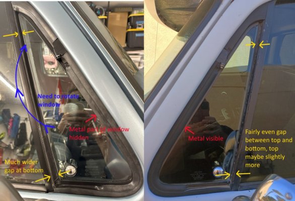

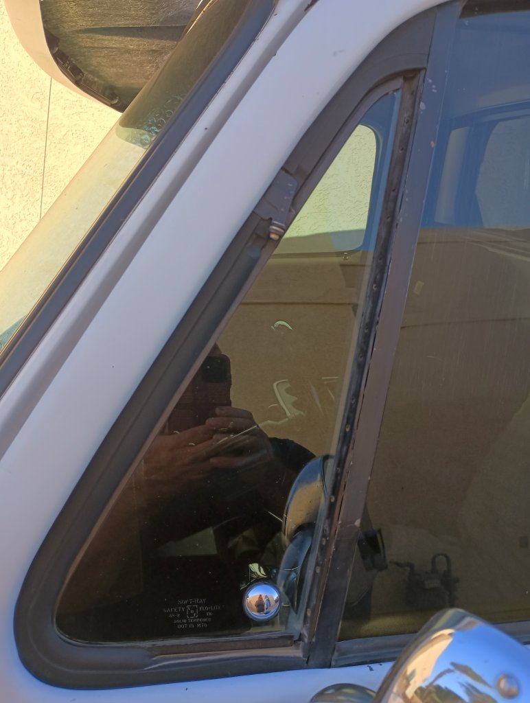

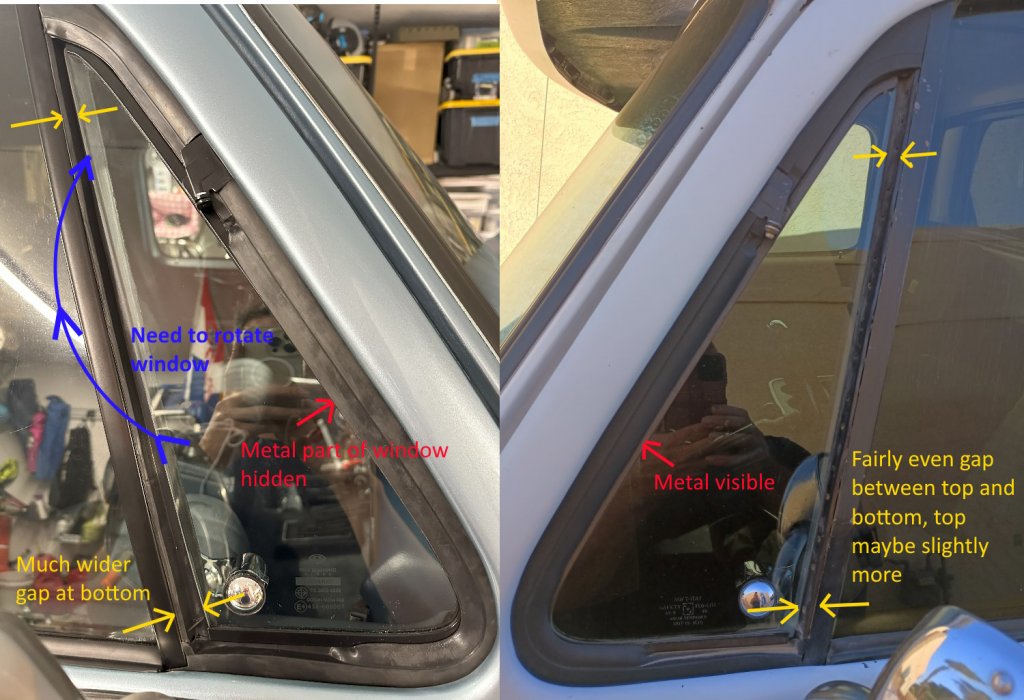

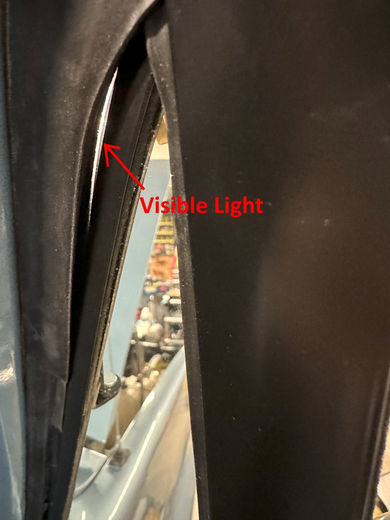

I just got my vent windows back from Precision who did a full rebuild on both. I was hoping it was going to fix the wind noise I was having around them, but it seems actually worse. I’ve attached a video and some pictures. The seal at the top is not adequate. I’m getting a ton of noise through it. I know, blare the stereo…. Is there an adjustment I am missing? It almost looks like the entire window needs to be rotated clockwise. I am not getting enough of a seal at the top and it looks like the bottom has a ton. Also if you look at the back edge of the glass it isn’t parallel to the metal dividing support between the main window and vent window.

Looks normal. My windows are fairly new and looks the same as yours. The gap is not even but the rubber lip on the inside is the same distance from bottom to top. Are you sure the noise isn't coming from the door seal? They are notorious for that. GM even used a second seal on the cab side for a while to deal with it. I was able to adjust my doors to sit deeper in the cab so the door seals actually compressed and eliminated my noise issue.

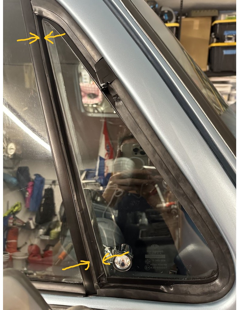

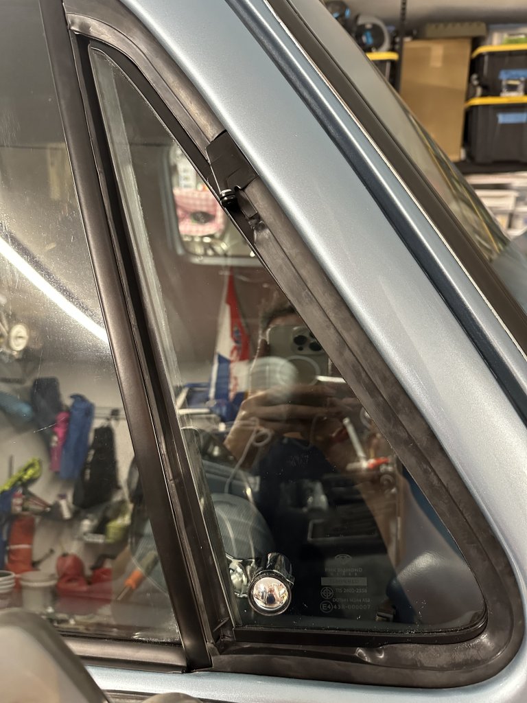

I have replaced the weather stripping in the entire truck. I purchased the second door seal but I can't figure out how to mount it. I can't seem to figure out the correct orientation. I am almost positive it is coming through the top of the vent. I have the dash all pulled apart now working on the radio but I will try and go for a drive tonight with it all taped up around the vent. But you can see light coming through at the top. (picture attached). On your window you seem to have a pretty even gap between the vent window glass and metal at the aft edge (picture attached).

So I emailed Precision and they got back to me first thing this morning. Here is what they said:
"To adjust that vent window, I have included a picture of how I rotate that glass frame forward. To do that you want to push vise grip towards the back of the truck to rotate the glass frame forward into the seal."
With a combination of doing that and pushing the window here aggressively:
(note the window is slightly open so I can push on the glass)
I was able to make a big difference. I can't see light anymore and it seems noticeably tighter in the trouble area. I still have the inside in pieces working on the stereo/backup camera/USB cords for phone charging. Hopefully this weekend I can take it for a drive and see if I have eliminated the noise.

Interesting. I wonder if the window got tweaked at some point or it's just a mismatch of parts resulting from the typical lack of quality control from that era. Thanks for sharing that.
