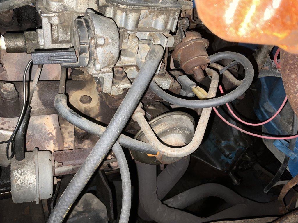

would this help. from what i am seeing from your truck photo i have the twin.
I have disconnected the kick back,throttle and spring from the rochester verejet II from carburetor.
Any and all information you can pass this way would be very much appreciated.

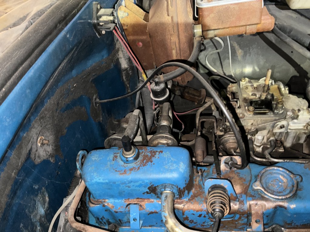

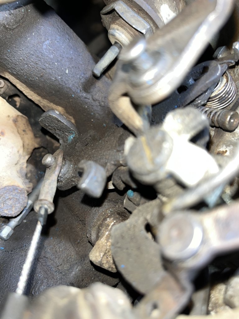

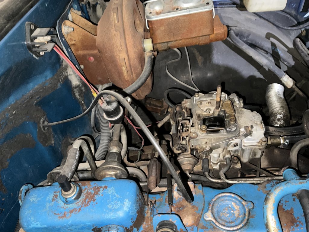

LilRobert1367,
The two images show where the spring and the accelerator cable attach onto the valve cover.
if you look close the springs and the cable are not hooked up to the carb in one of the pics.
The two combined springs will pull the accelerator linkage back to the home position.
The larger cable is the accelerator. connected to the gas pedal.
The smaller cable is the detent for the transmission.
Two cables two springs.
