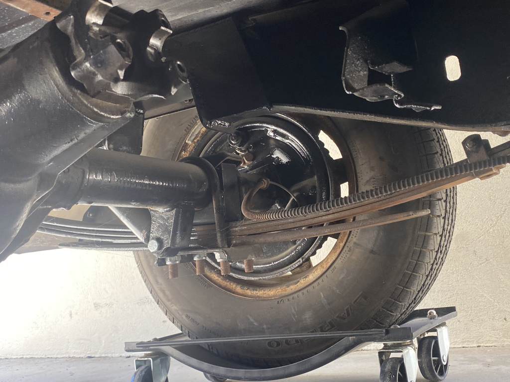

My project truck was lowered by the previous owner and is way too low for me in the rear with a bunch of rear-end sag. Front end height is good. He C-notched it and used 1'-2' drop hangars. I put stock hangars back on it and gained back 1.5 inches. I still need almost 4 more inches. I need to get this done so I can get the new driveshaft length dialed. I can't see any way to raise it other than flipping the axle back and then using the drop hangars again. The question is, can I simply reverse the flip? Theres a block between the axle and leafs and I'm wondering if that existed originally or was part of a flip kit? I'm worried if I simply flip it, it's going too high. Thanks

Yep, you can just unflip it. You won't need that little block/saddle as that's flip specific. The springs will just sit on that pad on top of the axle. Then you'll simply need to buy OE u-bolts and reuse that flat retainer plate. You'll probably need longer shocks at that point too.

Since you're worried it will be too high, measure from the bottom of the spring pack to the top of the upper perch on the axle. That's how much height you will gain by unflipping.

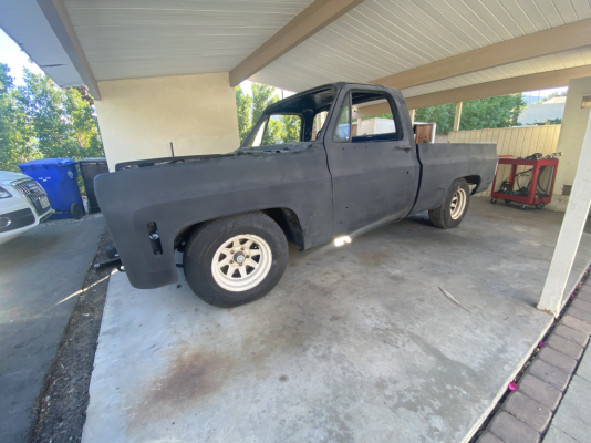

Got a picture of the whole truck? I'm just curious what height-ish you're going for. The "chevy lean" is super common, especially in the '81-up single fuel tank trucks because the tank and driver are both over there. Most of the time, you'll need to either use shackles in the rear set to different heights or trim the front springs independently until you're happy. I had to trim my pass spring more than my driver's spring to get my truck to be mostly level.

Tank is going on the passenger side. I'm going with the lowering leafs as this thing will be too high after flipping the axle back over.

You may find when you remove the "U" adaptors, that the the spring pin hole is not centered. The adaptors were made that way so when the truck was lowered using these, it moved the axle back. You did not have to shorten the driveshaft. So when you set the axle under the springs your driveshaft may be the right length.
Also to note, the "U" adaptors may have torn the original spring saddles at the weld. The original saddles were not meant to be used that way. Please check the welds.

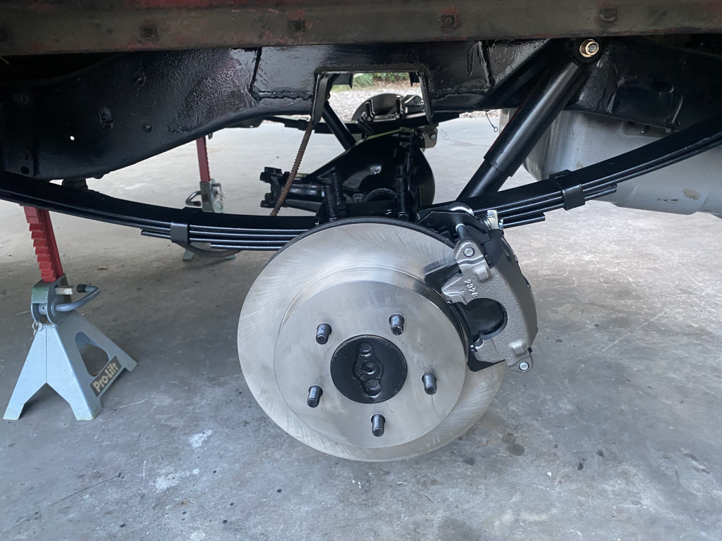

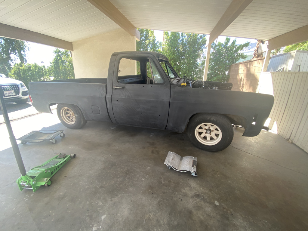

Updating the thread: installed the -3 leaf springs, re-installed the -2 shackle and flipped the axle back over. Looks good to me. Re-installing quite a few things soon which may change it but good for now. Thanks for the help. Couple pics attached.
