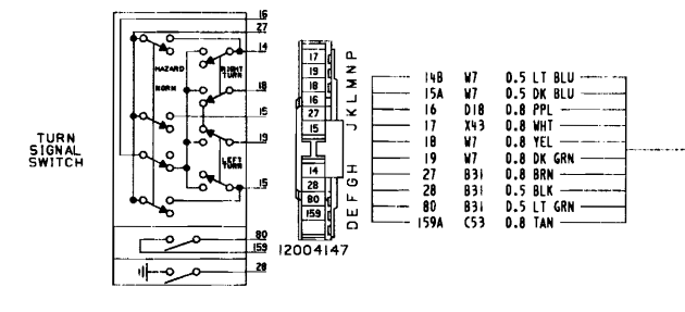

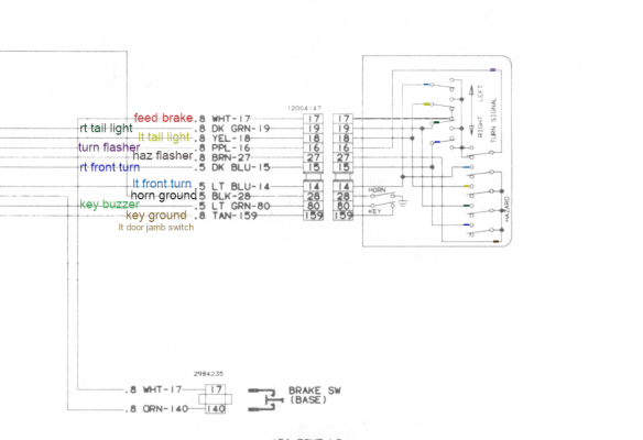

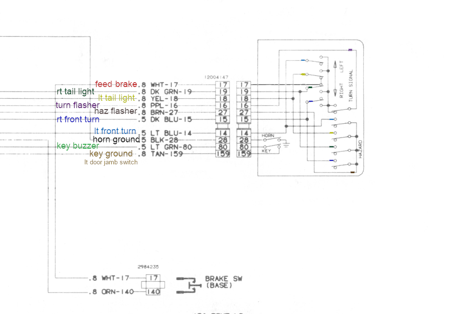

Maybe someone has a pinout/wiring diagram handy?
Like @Goldie Driver said- check the connection first.
Also need to ask- Is changing turn signal switch the only thing you did or did you also do something else like changing bulbs? (Incandescent bulbs or LEDs)
