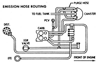

hey guys seriously thanks. But ok that last diagram is wat i found to go off of when i replaced all my hoses the first time. But the thing is (man im just goin to go take a pic) BRB.

soo yea, also i didn't take a pic of the missing other black canister, sooooo the hoses from thos orange and purple valves are gone, also all the hoses from that other canister and some of the one that is still there is missing some.

Ok, well...we can make this stuff work.
the vac switch the in the manifold is for the EFE valve, which is that vacuum motor mounted on the bracket that comes off the exhaust manifold.
That vac line would come off of the plugged port on the bottom passenger side of the carburetor, to the switch, and then back to the efe valve
but there is a check valve that needs to go in there. You may want to go back and see if he has any of that stuff.
The orange one is definately for the EGR valve, but I need to peep a couple of diagrams.
But, before all this is done, It would really be great if we could at least do the intake manifold gaskets, that way, we can check it off the list for possible vacuum leaks.
