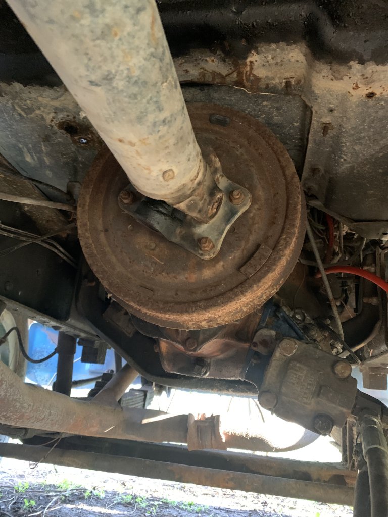

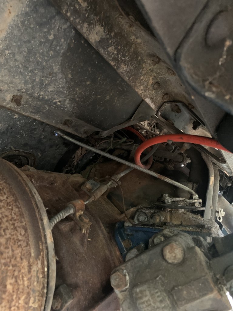

1987 C60 with a governed 2bbl Zenith equipped 350. 4spd manual with pto and tailshaft parking drum.
Cab is junk, would like to repurpose the engine/transmission in a different truck. Already going to swap the Custom Deluxe manual door guts/panels onto my 85 C10, tired of pw/pl failures.
Getting ready to drag home a C30 with a grenaded 6.2/Th400 combo. C60 is here and fubar so…
Thanks for any help.

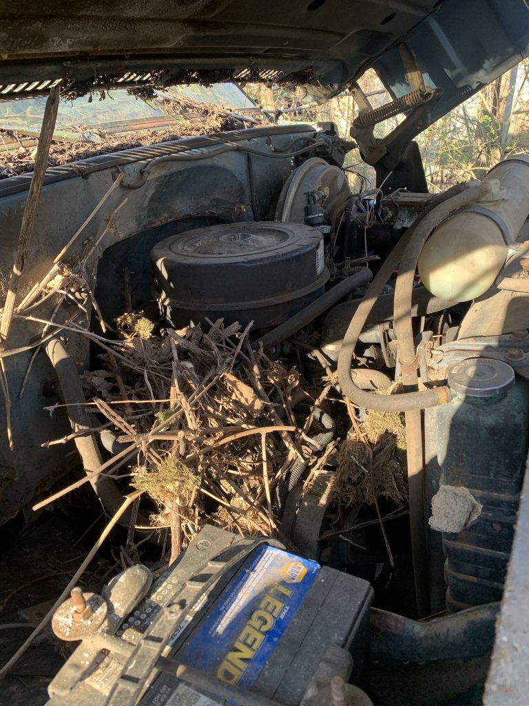

F’n possums…

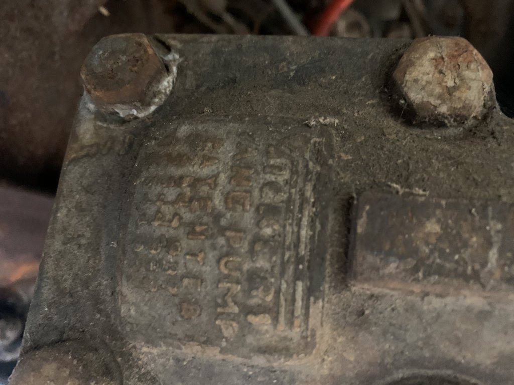

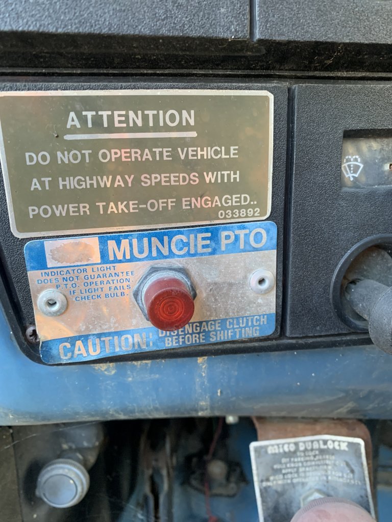

The transmission is most likely an sm465 but there no good pics of the transmission itself, just the parts on it (PTO, ebrake, etc).
31,797
32,345
It does look to to be a 464. Iirc, most of the medium duty trucks with a 465 used a larger input shaft and needs a matching clutch disc.
