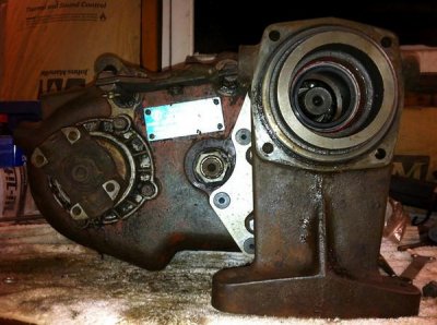

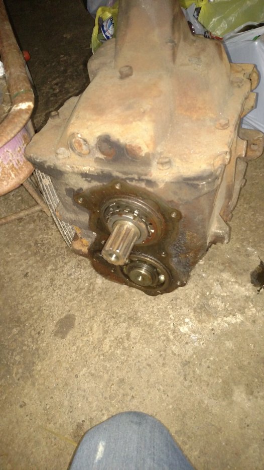

That would be the transfer case set up I have now, and that is the 10 spline 465, pretty sure I would just have to get that 8 pattern adapter right? I mean either way I still have options. Like my plow truck has a 465 bolted to a 208 and I do have the 4500 with low miles lol. The 80 Scottsdale has been sitting for about 3 years and I figured its time to get her going again. I have a healthy 355, 14 bolt full floater 3.73's 3/4 ton. I will post a pic of her. It needs some body work but the under side is clean.didn't see a winter for 25 years until i drove it last, 3 years ago

install the nv4500 in the truck then find a np208 from a 81-87 k10/k5/burban and there ya go?
